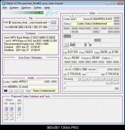

    After hours and hours of trying to get this to work, I am stumped. About a week ago, I made a video using MeGUI, encoding with x264 and LAME MP3. The video command line was this:
    program --level 5.1 --preset veryslow --pass 3 --bitrate 24000 --stats ".stats" --output "output" "input"
    The LAME MP3 config was VBR with quality at 100. This gave the following result:
    YouTube liked this. Good enough.

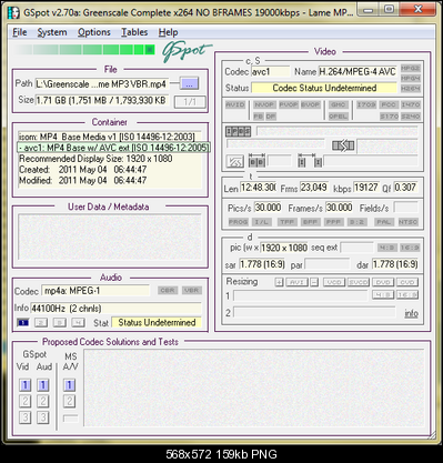

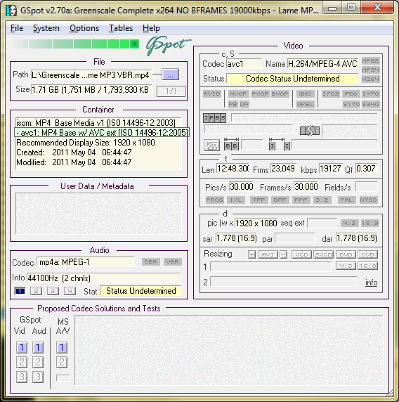

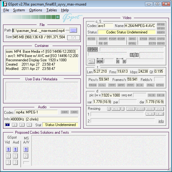

    Now I'm trying to help a friend upload a video with the same exact settings. His command line is identical to mine above, except he changes the --pass to 2 and adjusts the bitrate down a bit. It results in the following:
Name:	GSpot - rift video no bframes version.png
    YouTube chokes on this. "Failed to convert". It's reporting the video to be in "MOV" format, despite the fact that it is not. The extension is MP4, just like the video I uploaded a week ago, and the internal workings of the video are, evidently, identical to my video from a week ago which YouTube did handle properly.

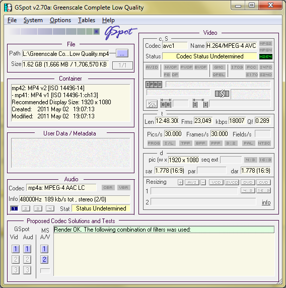

    In a mild fit of desperation, my friend made an Adobe Media Encoder (H264) version of the video. The resulting quality of said version was really just awful. But! YouTube liked it just fine. And here's how that looked in GSpot:
Name:	GSpot - media encoder rift video.png
    So I don't know. I've tried everything I can to narrow down the problem, and it really seems to me that I've narrowed it down so small that there's no room left for an actual problem to exist. Yet YouTube thinks there is a problem. So please help. ;/
  2. youtube has problems with some types of mp4 muxed files, incl. some versions of mp4box.
    rewrap in mkv and upload
    do some small tests first, instead of wasting time uploading 1-2GB files

    DS (one of the x264 dev's) has stated Youtube's mp4 demuxer is broken, and this is a known issue (along with other issues like decoding and sync problems).
    I did a bunch of tests, and it's hit or miss when you use mp4. L-Smash works better than Mp4box. The difference is the wrapper or muxing. All files that failed for me or had problems (like decoding or sync isses) were fixed when wrapped in mkv and re-uploaded. Others have reported similar experiences if you search

    Okay, thanks. I can actually breathe a sigh of relief that it was in fact YouTube's fault and not something I was stupidly overlooking.
  7. Well if it STILL fails after re-wrapping in mkv , then it might be something you did
    But mp4 container is known to be problematic for youtube, and not very consistent

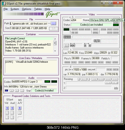

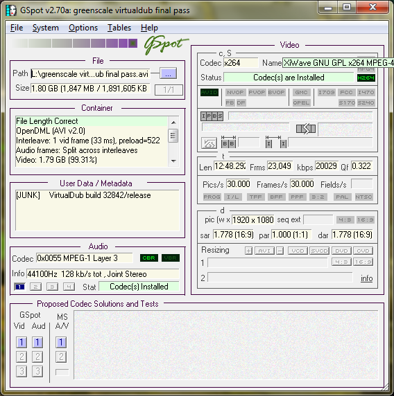

    For what it's worth (for anyone else who encounters YouTube headaches), my friend finally got a successful encode by skipping MeGUI and creating it via VirtualDub (still with x264). This is not to lay any sort of blame on MeGUI since what it generates certainly plays fine locally. YouTube has issues. All I'm pointing out is that these issues can apparently be avoided by using VirtualDub rather than MeGUI.
  13. Was this the VFW version of x264 , or through vdub external encoder feature using x264 cli?
    Was it AVI wrapped or did he specify a different container?
    May 2009
    Must be the latest, though he says he had to grab the codec specifically for VirtualDub, so it looks like there are significant differences between MeGUI's (and AME's) output and VirtualDub's.
Name:	rift - virtualdub.png
    Just an AVI.
