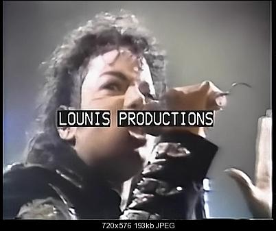

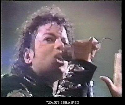

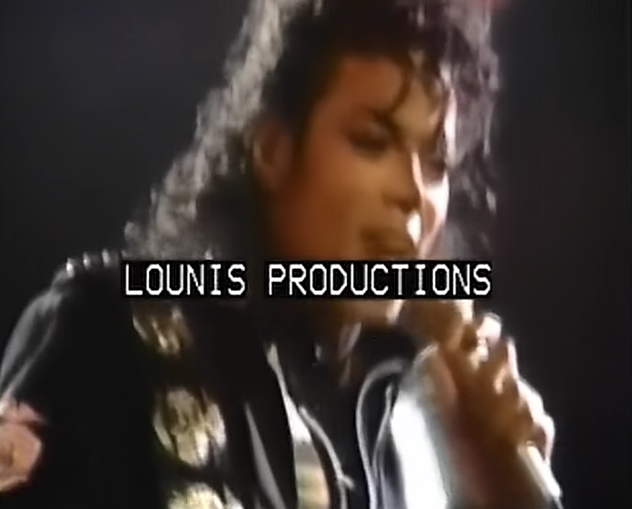

  20. What is strange is that the video with logo seems to have been blend deinterlaced (if you look at his finger)

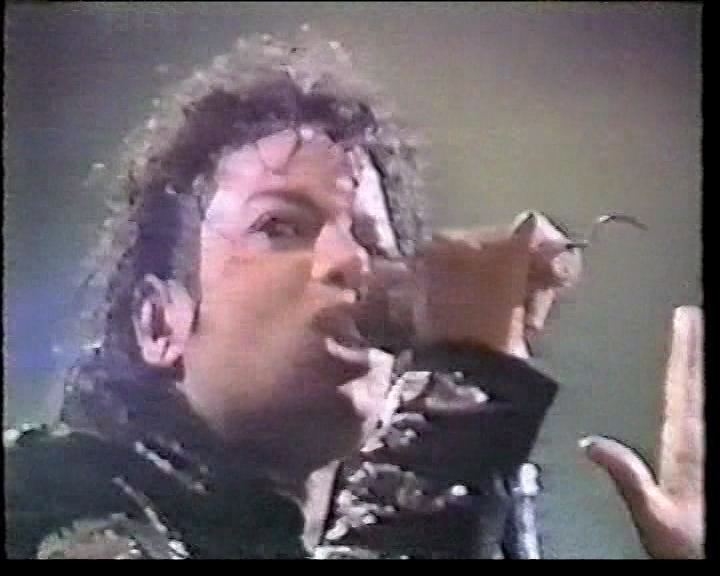

    But if I apply a blend deinterlacing filter on the other video, the two fields will be blended on the scene change which is not the case in the video with logo.
    How is it possible that the video with logo use a blend deinterlacing filter but doesn't blend the scenes?

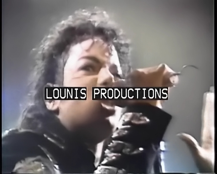

  21. No it hasn't; I think the logo clip used different deinterlacer or at least the blends weren't as bad. It may have been processed with other filters afterwards (like noise reduction), but I don't think blend deinterlacer was used on it
    The tell tale signs of blend deinterlacing are ghosting (double image) in your "without_logo.avi"
    If you use non blending deinterlacer on your mpeg2 sample , eg. yadif, or qtgmc - you don't get that transition problem
    Compare them in avspmod and you will see . Push f5 and use the number keys (e.g. 1, 2) to flip back & forth between tabs
    Look at the edges, how more crisp they are in the logo clip: eg.
  22. Originally Posted by poisondeathray View Post
    No it hasn't; the logo clip used different deinterlacer. It may have been processed with other filters afterwards (like noise reduction), but I don't think blend deinterlacer was used on it
    yes but look at his finger.. there is a double image..
  23. Originally Posted by mathmax View Post
    But this can be from other reasons, like camera shutter, motion blur, motion compensated denoisers
    Look at the majority of the frames - they are unblended in the logo clip. But the majority of the frames with motion are blended in the withoutlogo clip
    Look at the shoulder badge in the screenshots above, and the edge of mj's shoulder
    This is a contributing reason why you have difficulty matching up the mask - they've been processed differently

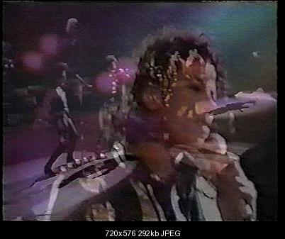

  24. Originally Posted by poisondeathray View Post

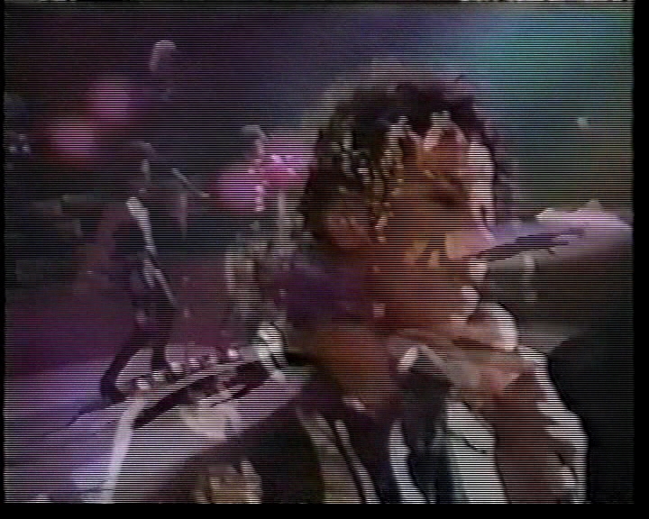

    mmm.. that is strange
    interlaced
    yadif
    blend
    the blend picture looks very like the one one the logo version... do you think this double effect is caused by something else?
  25. Originally Posted by mathmax View Post
    I gave you other possible reasons for the doubling effect . It's possible some blend deinterlacer was used, but the blends are way way way better than the one you used. He might have used a smart blend algorithm, only partial blends according to a motion mask, but you used a "dumb" blend algorithm, where everything is blurry and blended.
    I'm 100% certain the blend deinterlacer you used is not the best choice. Again, compare the images in avspmod you will see this clearly.
