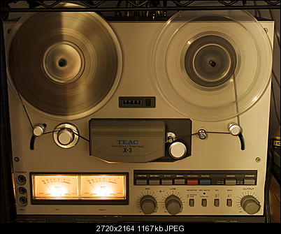

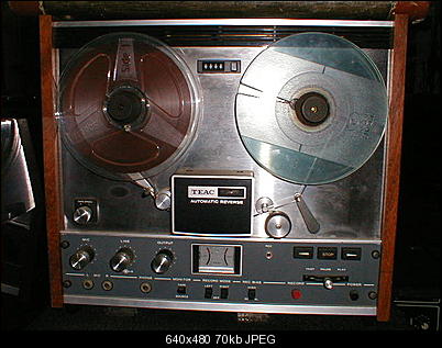

    Assuming your tapes are on 7" reels, you will need a model similar to these Teacs in good working condition. The early small reel models were numbered 2xxx (two thousand). Late models were X-3 variations.

    Note that most of the large reel models will lack a 3 3/4 ips speed option.

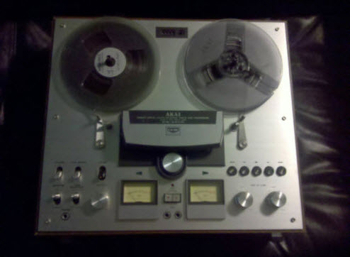

  11. Ok, well, I took a few tapes to an audio business and the converted 2 tapes for me. The problem was that the broke them down into tracks and we can't figure out for the life of us what order they go. They gave me 13 CD's with all the audio. So I have decided that I want to go ahead and purchase a machine and do it myself. I'd like to spend under $150 for a machine. My problem is, I am not totally sure what I am looking for. Everything I see on Ebay doesn't say anything about 2-channel or 4-channel. and I am worried about the product not working when I get it. Does anyone have any recommendations for me as to what to get. I'd be happy if someone just held my hand and sent me a link to one they know would work for me. It doesn't have to be from Ebay either. After I transfer the tapes I would probably be looking to resell it.
    Thanks for everyones help.
    I guess another question would be, If the tapes I have are two channel's per side, would it matter if the player I bought was a 2-channel or 4-channel?
    I found one on Ebay that looks ok. Any thoughts?

    The pictures obscured the speed settings.
    It all comes down to condition on this one. The seller doesn't know or won't say. Price way low for a good one.
    The best ones will be found in estate sales. The average owner would be in late 50's - 80's.
    Anything from the broadcast/radio or post industry won't support the formats you want.
    I've had one good and one bad experience buying reel to reel machines on eBay. In the future I would need to evaluate the machine before I buy one. I have 3 reel to reel machines now (all three motor) and all need TLC to operate properly. Covers off and a little tweak or lube here and there.
    Even if the machine works, old tapes may have problems.

    i can see 7.5 and 3.75 on the speed switch in one of the pictures. they weren't very good recorders at 7.5 so i can only assume 3.75 is going to sound pretty bad. the wow and flutter on those beasts was awful, not to mention the cheap heads that had poor freq. response even when new.
    use it and sell it back off quick. use q-tips and rubbing alcohol frequently to clean the oxide off the heads from the old tapes. they will shed quite a lot.

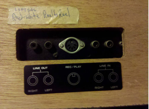

  16. Any ideas what I can do to hear my reel to reel player in my computer and through player at the same time. attached is a picture of the front and a picture of the back(took both from the internet so I wouldn't have to take them).
    Thanks so much for your help.

  17. Don't connect through mic-in!! Use a line-in. Mic-in preamp cannot handle the levels. Even if you set the PC input recording levels very low, it will still be brickwalled.
    Darryl
  18. If your laptop PC doesn't have a line-in, you might be able to buy a USB sound card. Then you could connect line-in to the device. Even then you need to make sure the preamp can handle it. Or maybe you could get a flash-RAM audio recorder $100-200 (and up). Or maybe even a standalone CD recorder. Or perhaps you have a standalone DVD recorder. Just run the audio only... and use the highest quality (hopefully you can record LPCM).
    Darryl
  19. Just a couple more tips:
    Even using Line-in, I would treat your sound card carefully and slowly raise the volume from silent on the tape player until the levels seem right in Audacity's meters. Not sure what the chances are of blowing the sound card but after ruining couple myself I've taken to treating them with cotton gloves, especially in a laptop.
    Also, you should really have heard something when recording from the Mic plug so if the same thing happens using Line-in, make sure nothing is muted in the Windows mixer or the sound card driver software (if present).
  20. Thanks for the replies.
    setting in Audacity that says "Playthrough while recording (uncheck when using stereo mix)".
    That fixed it so I can now hear it while recording.
    So when you guys say I need an amp can I use just a regular stereo receiver?
    I have a Pioneer VSX-403 Stereo Receiver. Can I use that?? I am assuming that would have a composite out that would go to the computer.
    Ok, so my computer is a laptop that doesn't have a line-in.
    Should I use a desktop and just use the line-in that is integrated on the motherboard?? Probably a green or light-blue input on the pc, I think??
    What is the advantage of using a receiver? So that I can turn the reel to reel player output volume up and then I'd have to turn the volume down on the laptop???
    Thanks for everyones help! It is sooooo appriciated.
    I'm pretty new to this so sorry for the basic questions just wanting to make sure I understand everything.
  21. Line-in would be blue, I believe. The headphone/speaker out is green, and mic-in is red. You need to be running the sound into your PC at line levels. The mic input cannot handle it.
    That's good advice about bringing the levels up slowly. There is always the chance that the line-levels coming out of your reel to reel is too strong for the preamp in your soundcard. If it is, then you may be able to use an old tape deck or something to "condition" the levels a bit. Basically, you would run the sound into the line-in on the tape deck, and out through "monitor" (if it has one). Then to the line-in on your PC. You are basically betting that your tape deck has a preamp that can handle the hot levels coming out of the reel to reel.
    I use an old portable DAT recorder to "condition" my line levels. It has a very strong preamp, so I know it can handle the line levels from all my equipment. I run line-in into the DAT, and coax S/PDIF (digital audio) output to my soundcard (which happens to have a S/PDIF input). And I set the levels on my DAT.
    Good luck!
    Darryl

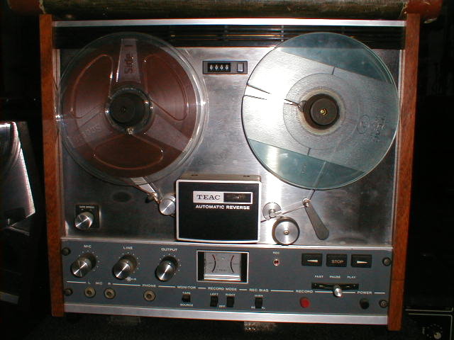

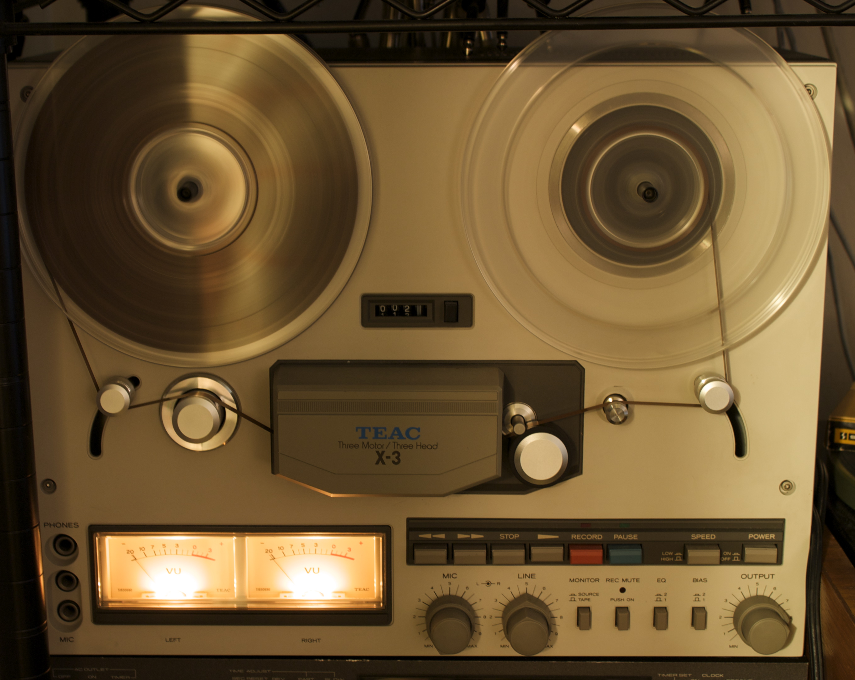

    My reel-reel tapes go back to the 1950's when my parents bought a Sears Silvertone recorder. I mostly recorded music off radio in those days, also TV sound (pre VHS). This continued through college sharing music and sound effects clips. Later I edited/layered 4 track live recordings with a SIMUL-SYNC Teac 3340S. Still have that deck.
