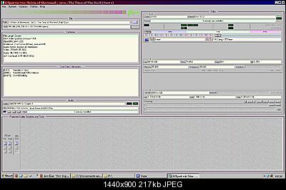

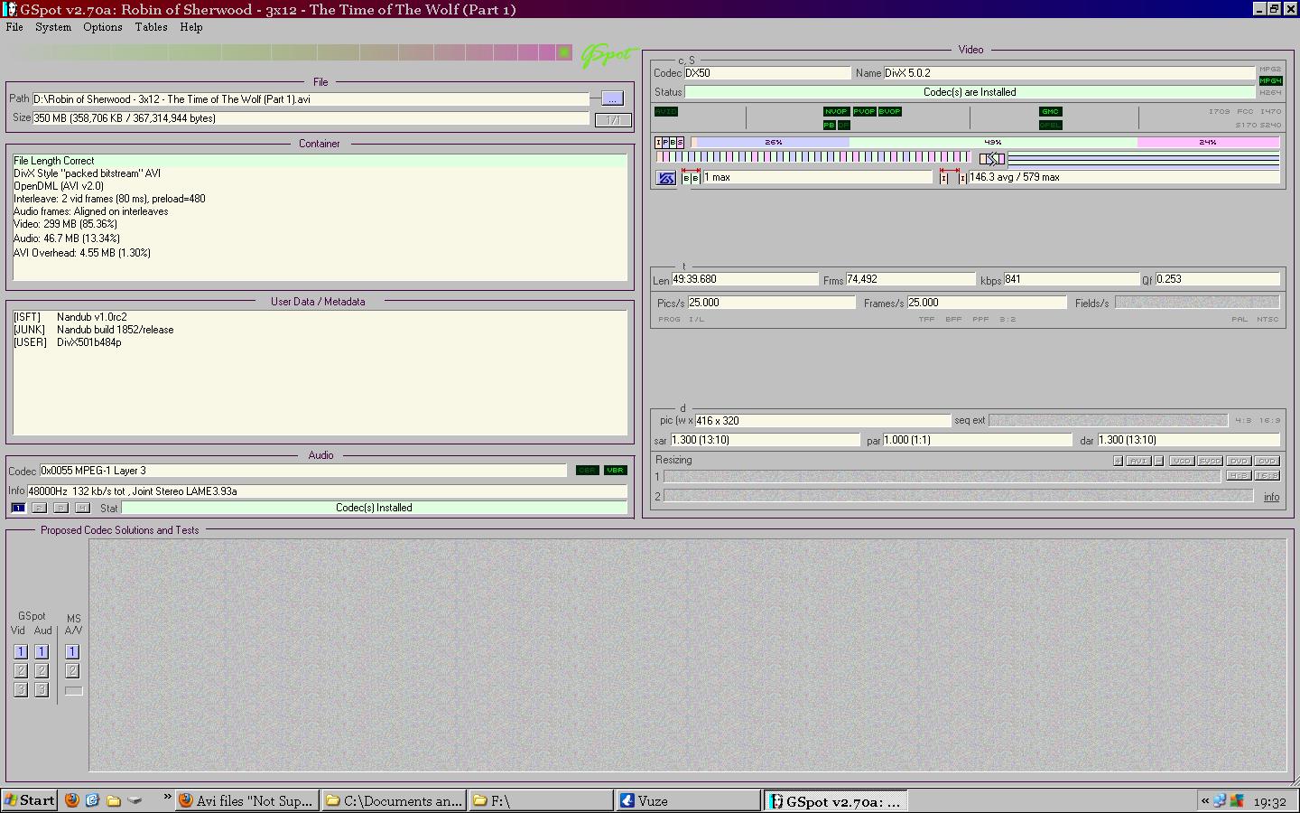

    Thanks, here is a screenshot of Gspot's result;-

    aelfheah,
    The only thing that sticks out from gspot is the "GMC" (Global Motion Compensation) box being lit up in green. Several years ago it was a somewhat common practice for people to encode with the GMC option turned on because people encoded for playback on computers, which had no problem with playing back GMC-encoded files. When standalone players came along, though, it caused problems due to the low-powered chips being unable to decode the files. Most would just say "Video not supported", although some would attempt to play the file and then glitch when they encountered certain scenes. As a result, you rarely see files these days that are encoded with GMC.
    GMC was always pretty useless, unless you had a scene where, for instance, a camera was panning while being raised/lowered, rotated on its axis, and zoomed; then it might save you a few bits. I'm hazy on the details, there are some good discussions on doom9 about it, though, if you're interested.
    If that is indeed your problem, the only cure that I know of is to re-encode. If you're new to re-encoding files, type: recode avi gmc into Videohelp's search box and it'll point you to some guides.
    I had to re-encode many such files back in the day, though it's been a few years. There will, of course, be a slight quality loss, but if done right, there's a good chance you won't even notice it.
