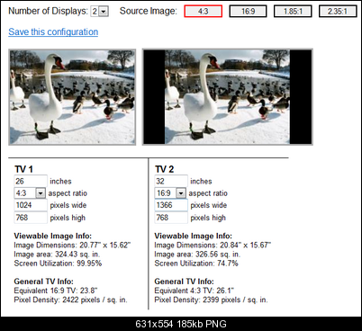

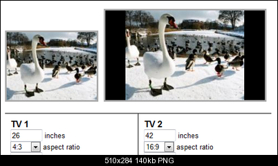

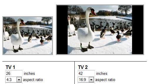

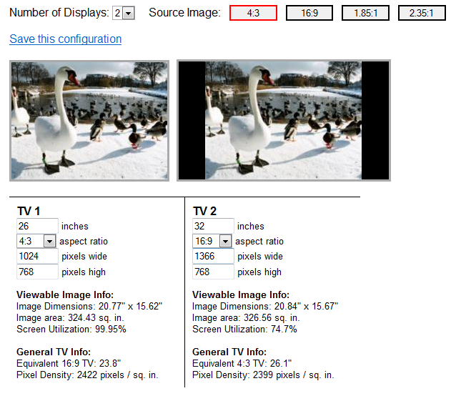

    Agreed. Even a bedroom needs at least 42".
    A 32" 16:9 TV has about the same 4:3 image size as a 26" CRT. Try this calculator.
