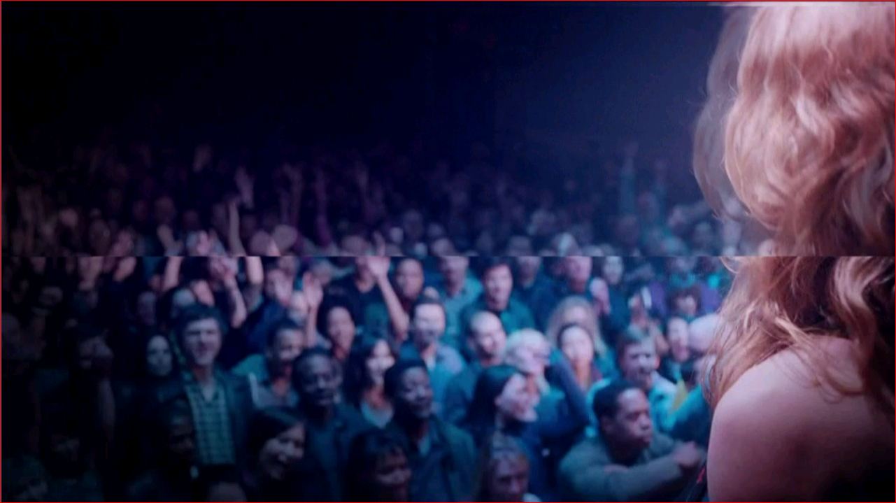

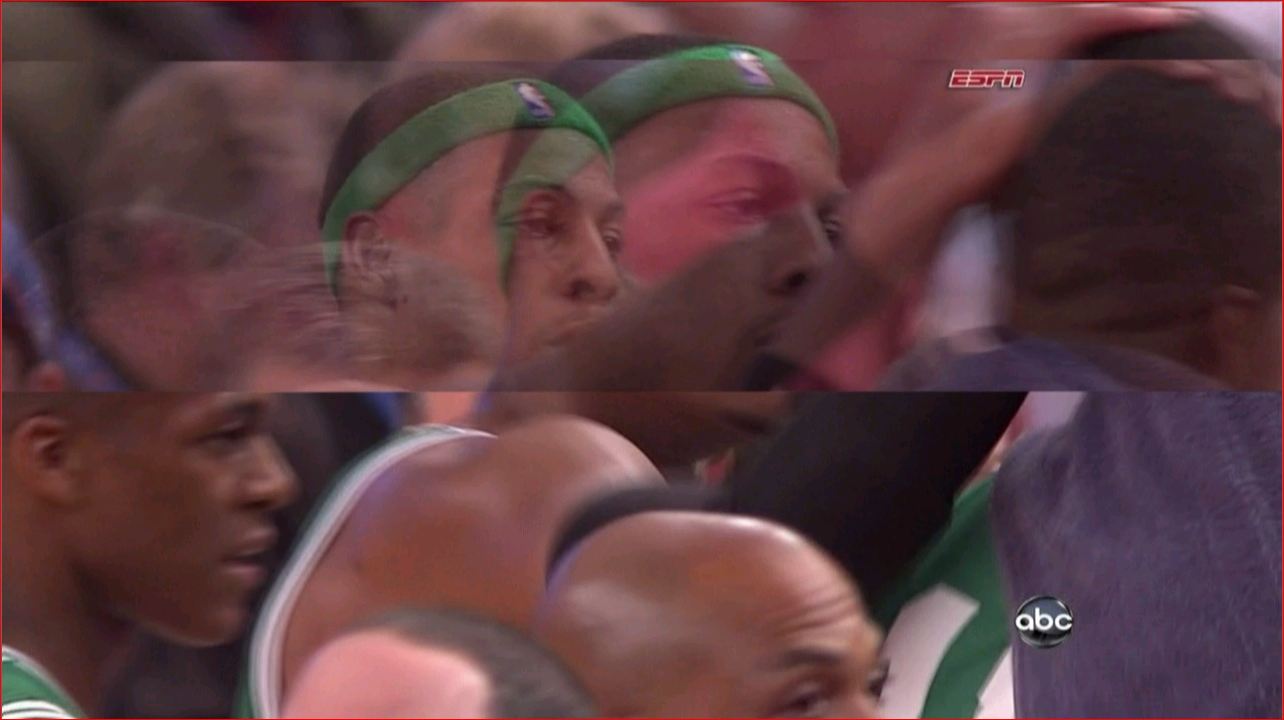

    I recently purchased a AverTV HD capture card (specifically the AVerMedia AVerTV HD DVR MTVHDDVRR)...and am very glad I did! This thing is great...only problem is the more I use it to watch HD tv the more I've begun to notice that periodically the video stream will suffer a glitch while watching video via HDMI (both in the preview screen and in the actual capture). Examples below... (these glitches occur for only a single frame in the capture)

    I will admit that the glitches may be due to one of two possibilities:
    1. I use the bundled software that came with the card. I've read from several sources that I should be using a 3rd party software to capture on this card (virtualdub, fraps being among those mentioned)...but I can't seem to get any other programs to work with this card. If someone could help me out here that'd be great!
    2. I'm using an older set of drivers for this card...need I mention why?
    If anyone can help (or at least point me in the right direction) that'd be greatly appreciated! I haven't seen anyone else mention this particular video error afaik...but I have read reviews that mention the HDMI input on this card was "touchy"...could this be the "touchiness" they were referring to?

    The images show two problems:
    1) Tearing -- part of the image is from one frame and part is from another frame, with a horizontal "tear" between the two. This occurs on-screen when the frame buffer is changed while the graphics card is sending the frame to the monitor. This is usually fixed by enabling the vertical sync option in the graphics driver. If the torn frames are also in the caps then it's some kind of hardware/driver problem.
    2) Blend deinterlacing -- where the two fields of an interlaced frame are being blended together rather than being displayed individually. This could be related to the first problem if there is a hardware/driver failure.
    I would try capturing with the image preview turned off. That will eliminate that as a contributor to the problem.
    Always-on in their software, unfortunately. Applied to both preview and the captures themselves.

  7. Dual monitor setups often lead to tearing problems. Tearing also occurs if two media players are running at the same time. Only one gets video overlay with vsync, the other writes to the Desktop without vsync. Which rendering device the player is using can effect tearing too.

    I think you should confirm whether the artifacts really are in captured files or if it's just that you're seeing a video card issue on the overlay both times.
    Try grabbing direct shots of the captures on those frames instead of the output of a media player. Use an editor like VirtualDubMod, Avidemux, etc. Or upload samples here so we can check whether we see the same thing.

    So I removed the second monitor and attempted to view the glitchy video files and they were still there (in media players I have: MPCHC and KM Player and also in Avidemux), I also attempted to capture new content and the glitches were still present . Also, every time I run a capture I make sure to have no background programs running and I even do a reboot just prior to capturing
    I opened up the video files that contained glitches in Avidemux and they were still there.
