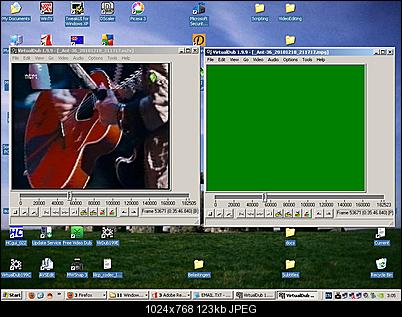

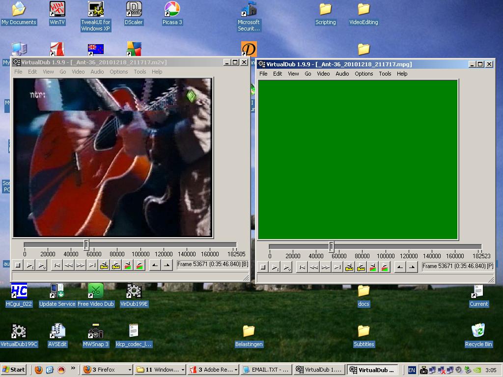

So far so good. But after half a hour of film [out of two hours] so encoded, the image turns black [from frame 53671 and remains black forever.
As you can see in this frame [which is B-picture] the iimage is divided in an upper and a lower section.
How can I get rid off thhis line? Any help would be appreciated. Many thanks in advance

It seems to me that in this case two frames are blurred [only using Virtualdub to show this to you; noot to encode the film]
