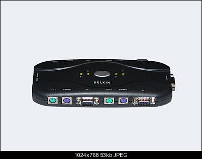

    Why don't you use a KVM switch to switch the 2 VGA to monitor VGA in like Jagabo suggested?
    example
