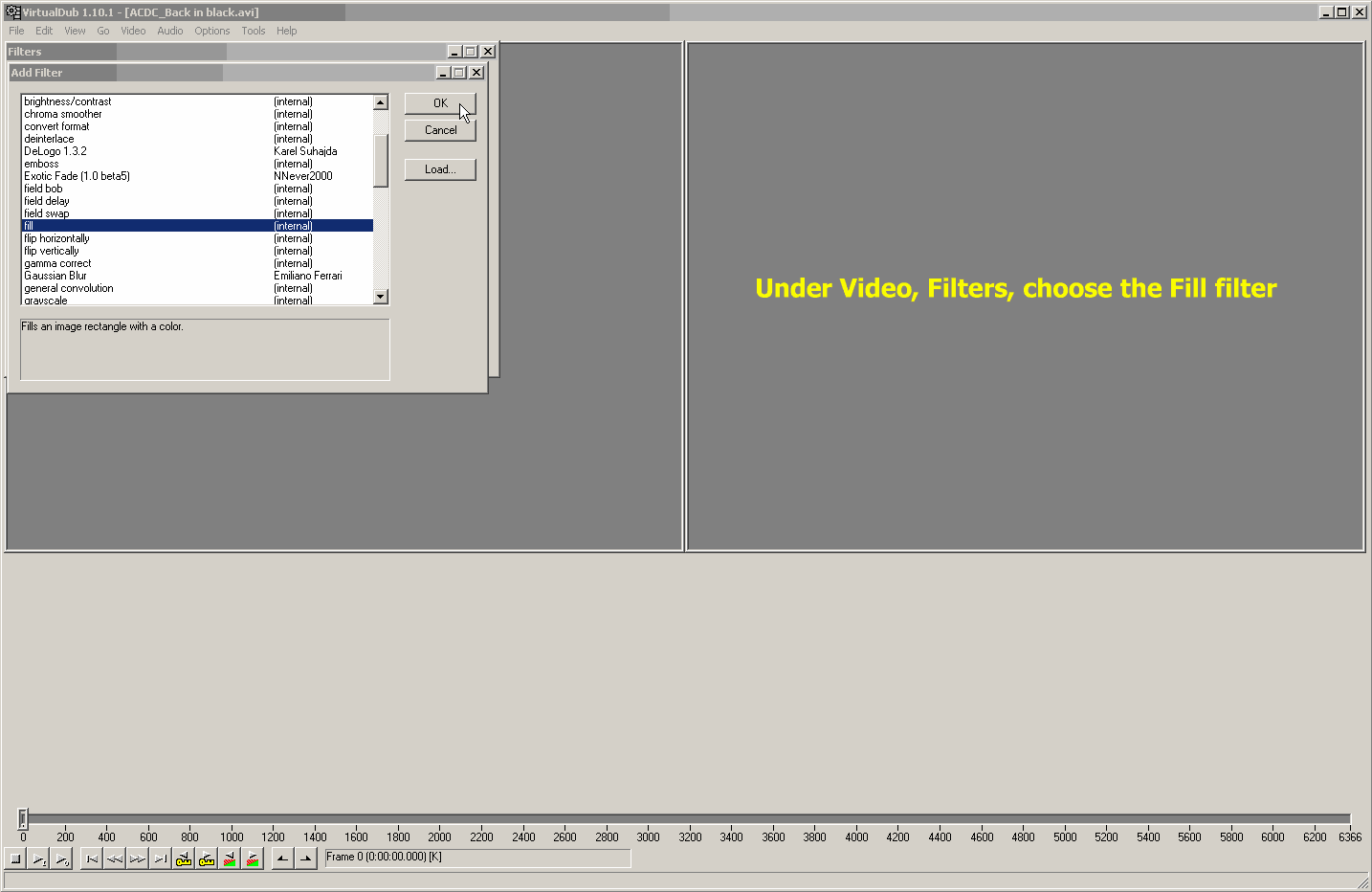

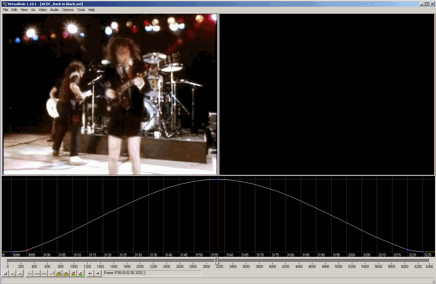

    Nov 2002
    You need to use the fill filter instead of the FadeFX filter to be able to fade in and out in different places in the clip. You can add as many fades as you want.
    Gif #1 shows fade in from black at beginning and fade out to black at end.
    Gif #2 shows a scene fade in to black and fade out from black.

    Nov 2002
    EDIT: Choose Video > Compression > Full Processing Mode > Codec used in original file > Smart Render > Audio > Direct Stream Copy > File > Save As AVI.
    Some filters are not made to run in Blend mode so you end up encoding the whole file. That is why it is better to use the Fill filter for fade to black (or any other color). Also if you use the curve editor and fail to get the outside points all the way down to the line then you'll end up encoding the whole file since the Smart Render sees the Curve being the length of the whole file.
  18. Originally Posted by DarrellS View Post
    That's a good point.
