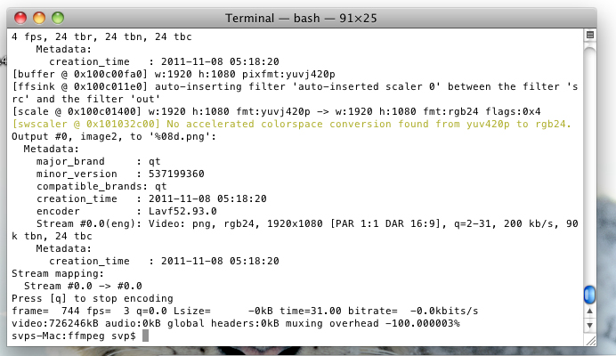

    My dear Vidgem,
    So far I got it run on VMWare MAC OSX Snow Leopard now but it seem that I still have some problem. Because I can not see the output files.
    I'm not sure what the exact problem is but I think it is problem with my input video. Can you help me please?
    below is the screenshot of my terminal after finished encording.
    Thanks for your time.
    [Attachment 9616 - Click to enlarge]
