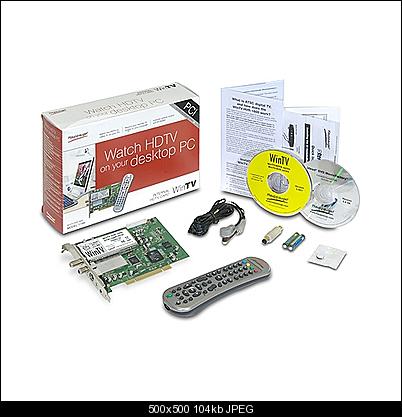

    When you split composite into Y and C without an active Y/C splitter, the result is luma contamination of the chroma*. Use a composite RCA to RCA (yellow) cable instead. Use the yellow adapter that came with the HVR-1600 and select composite input in WinTV7.
    In this picture, the composite adapter is grey in color. Mine was yellow.

    * this type of S-Video to composite cable is intended to be used in the other direction. Y/C S-Video out can be summed to composite but it doesn't work the other way around. Y/C must be separated with bandpass filters or with a comb filter.

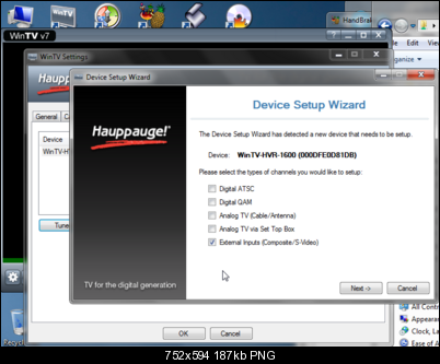

    In Hauppauge WinTV7 device setup you set the composite input here...

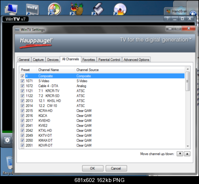

    You can move the external inputs to desired position in the channel queue here.
    Select composite input in Find Channel.

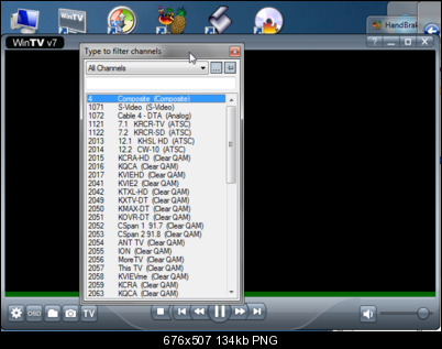

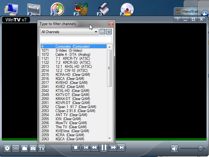

    Once everything is set up, you choose composite in Find Channel (right click on screen).
