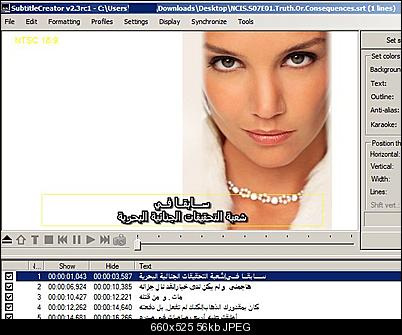

    Accepts it on my setup -I don't read Arabic, but it looks the same as the .srt file..

    Dear Sambat
    That is right it arabic. I asume that u used the same srt file i attached. Could you kindly descride the steps you followed to get the hardcoded file with srt to appear right. Also what setting did you have on Subtitle Creator.
    Thanks in advance
    Dec 2005
    Canada
    It's in post #5 - and the subs aren't hard coded;they are selected with the remote (if they are played on a standalone player).
