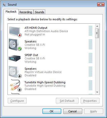

  5. Member yoda313's Avatar
    Jun 2004
    The Animus
    Assuming this is for Windows right click your speaker icon on the windows taskbar. Click playback devices. Your graphics card should be visible here. Click it and set it as your default playback device and you should be all set to go.
    Edit - sorry read you don't see it as an option.
    Check device manager. It might have a little ! over it. If it does it is a driver issue. You might need to reinstall it and try again.
    Edit 2 - also is this by chance dts audio? I don't know if the hdmi would properly play dts to your tv if the tv doesn't do dts (don't know any tvs that do but these days that may have changed with the newest generation of hdtvs).
Name:	ati hdmi out.jpg
