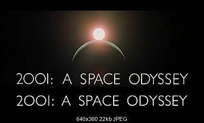

    Oct 2010
    England

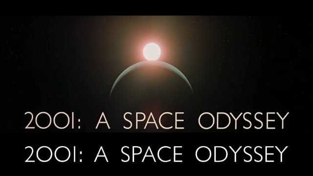

    What about GillionLightDB as an alternative font? A Google search will bring up some relevant pages.
    It looks like the film substituted the zero characters with upper case 'O's:
    http://new.myfonts.com/WhatTheFont/forum/case/289253/
    Here, the character spacing has been increased slightly and the word spacing has been increased significantly:
    top is orginal, bottom is modified GillionLightDB.
    There's a bit too much spacing between some of the characters - if you're bothered you could adjust the kerning.
  12. intracube, you said "alternative font" but the two fonts look exactly the same. how did you find GillionLightDB?
    im not sure how to do what you did here; the file that i downloaded from 3 different sites gives me a file with lower case font. anyhow it looks like you found a similar font for free and you were able to put it in the video so thats good news. if thats correct can you delete the subtitles in the video and put your own instead?
  13. The basic technique for "deleting text" is to make a clean plate. This is easy in this case, because there are frames in the video without text
    Look for a clean frame without text that looks exactly the same, eg. the frame before the text comes on, then you use that to overlay on top of the text .
    This can be done in any editor e.g. vegas, premiere , or even image editors e.g. photoshop, gimp

    Oct 2010
    England
    Non-commercial fonts sometimes use similar names to their commercial equivalents. I spotted GillionLightDB on an alphabetical font listing, and the sample looked very close to Gill Sans Light.
    Different commercial fonts can also use similar names - Times Roman/Times New Roman, for example. See:
    http://en.wikipedia.org/wiki/Times_Roman#Variants
    there's also examples of free alternatives.
    It's worth saying that free fonts don't always match the quality of their commercial equivalents. They might not properly support extended characters, for example àçéß™, and a typeface might not be available in many weights:
    http://en.wikipedia.org/wiki/Font#Weight
    I don't follow... Uh, [Shift] key?
    I forgot to mention, the "1" was replaced by a lower case "l": 2OOl: A SPACE ODYSSEY. But if you're replacing the text, it might not be relevant.
