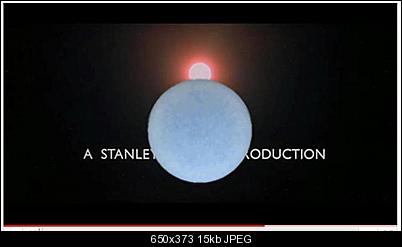

  11. It will look stupid if you do something like this:

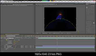

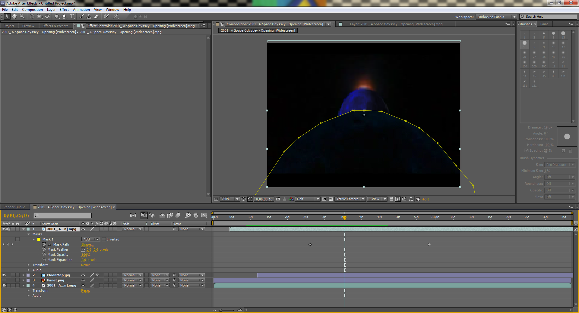

Name:	after effects.png
    After Affects Layout that accomplishes replacing a planet. Two layers of the film, the replacement planet between them, and an animated mask on the top layer that adds the front planet back in as it is being used to oscure the replacement planet.

    I created my own planet using a moon map I found on google images, then applied cc sphere to make it spherical + a transparent background, then I used cc colorama to change the color. I changed the radius so that it was about the same size as the planet, but large enough to block it from view. I created two copies of the film, one on top and one in the back as I needed to block out the planet for this I animated a mask on the opening moon so the moon remained visible in the foreground.

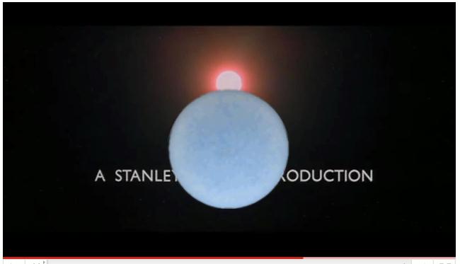

    Anyway buzz, I made a very loose reproduction. I did not resolve the text behind the planet as I would have to cut the film so that the "add" blending mode would not be continous.
  25. Member
    Feb 2008
    Twin Peaks
    Here's a very loose look at it having been replaced. I have the mask adjusted on my pc, but not the upload. For the text either the film would need to be cut, or the text masked out and replaced via a text layer. http://www.youtube.com/watch?v=o-rdHrL2aK4
