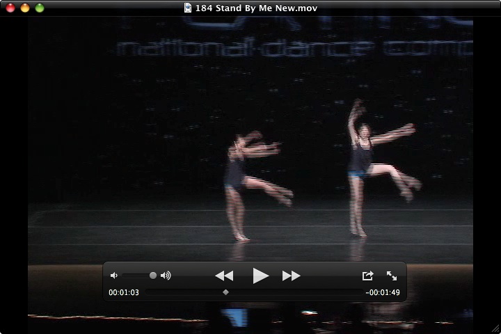

    I shooting video On a Canon XL2 @ with a frame rate 30. Covering a local dance competitions. I'm shooting tape and also DVD back-up with a Sony Direct burn.
    I had a tape error and now and ripping the routine I need from the DVD. With Wondershare DVD Ripper.
    The video looks and plays fine on my screen. However when I output from Final Cut Express the video doesn't seem to have the right frame rate. any motion from dancers results in tracers or ghosting of moving arms/legs.
    I'm fairly certain it is a frame rate issue I tried everything to make them look nice and smooth but I'm not a video professional just a guy hired to run the camera and edit the dances..
    Any advice or help would be appreciated.
    [IMG]Freeze1.jpg[/IMG]

    You might try MediaInfo to check the framerate on the original video and the processed video. What that looks like is interlaced video shown on a progressive monitor, IE, a computer monitor. A interlaced TV or monitor shouldn't show those interlace artifacts. But you could also have a problem with frame rate conversion.

    Thanks, for the advice. I'm new to all of this, as I'm sure you can tell. I had thought the problem was interlacing as well, the horizontal "lines" do disappear when viewed on my TV monitor but the double image is the real problem. each dancer has 4 legs and 4 arms (or more the faster they move)
    Your original video is interlaced.
    It could be that Final Cut Express isn't flagging the exported video as interlaced. Additionally, the field order might be reversed. If the field order is reversed, the video would judder/stutter when viewed on a TV, but possibly not on your computer screen (depends what software you're using to play the video).
    If you open one of the files from Final Cut Express with mediainfo, select View>Text, and copy/paste the text here to help confirm whether the file is flagged as interlaced/progressive.
    Also, why are you backing up the videos to a 'DVD-Video' disc? Doing it this way means the footage is being re-encoded to a (relatively) low bitrate stream - and that's likely to give a noticeable drop in quality compared to the original files.
    It would be better to burn the original DV files from the XL2 straight to a DVD data disc. That would preserve the original quality (although you wouldn't be able to store as many minutes of footage per disc this way). You also wouldn't need to use Wondershare DVD Ripper to get the footage back onto your computer.
