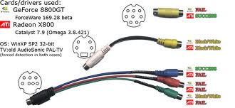

    A scan converter may take 1280x1024 in but the out will be 480i @ approx 640x480 resolution.
    TV ports look like these

    edDV has the picture to show you what the HDTV dongle looks like ... it is the one on the bottom of the picture.
    If your PC can allow you to put in a video card ... I chose the Geforce 7600GS because it is light on power supply requirements.
    It is a PCI Express video card and if your TV is new enuff to allow ... video component input connections ... your good to go.
