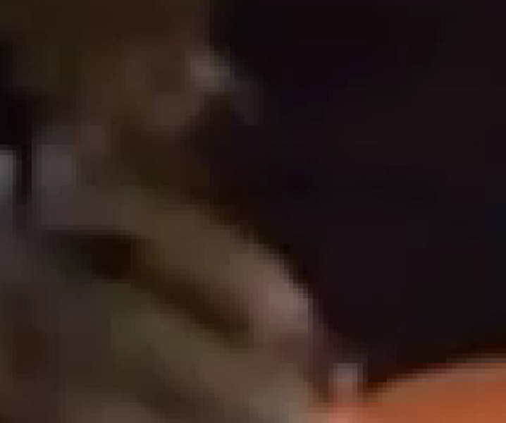

    I have a rather unusual request, I would like a peice of footage and image analysed by folks here who think they may have an opinion on the occurrences in the material, specifically the anomaly to the subjects hand at exactly 4:27sec, importantly I would like to ascertain whether there is or isnt a technical explanation to the strange imagery, all of your expertise is appreciated.... if anyone wishes to give their opinions to me privately please request so.
    I know not everyone is an expert ,im just after opinions
    the image and video are below, please also note that this image lasts for less than a sec in the video before returning to normal, is there a technical explanation for this or is it unexplanable?

  2. This is common. It's macroblocking or error in encoding .
    There can be several reasons for why it occurs, the most common is insufficient bitrate
    It occurs in other places too, look at 1:18 for example.
    If we assume the source upload was ok, then it's likely from insufficient bitrate . I suspect it's more likely the source had those errors to begin with, this looks like a webcam capture
    YT re-encodes everything with a low bitrate . It uses long GOP encoding . The short explanation is differences between a certain keyframe (I frame) are coded and stored as P and B frames. When a bitrate limitation is imposed, there isn't enough bitrate to encode what the encoder is asking for, that causes these defects.

  4. In addition to the problems caused by too low a bitrate, I think there were some transmission problems (from the guy's webcam to the woman's computer). That caused some of the video frames to be lost and the picture to get corrupted.
  5. thanks jagabo ,can we address what looks like a claw or talon so perfectly placed on his thumb, is this also a result of low bitrate ? are there two objects merging together to cause this look? how might this happen?
  6. Yes, I think that particular problem was caused by data loss during the streaming of the webcam video via the video phone software. In the second or so before that frame you can see the picture freezes several times for several frames. That's an indication that frames were lost in the transfer. When the signal came back motion vectors* in the new frames moved the wrong parts of the image and the result is that odd claw.
    * With high compression codecs most frames do not encode the entire image but only the changes from frame to frame. Motion vectors can be used to tell the decoder to move blocks of pixels from one location in the old frame to a new location in the new frame. For example, if the camera was panning to the side, the encoded stream could say the equivalent of "move the entire picture to the left by 6 pixels, then add this 6 pixel wide vertical strip if new image to the right edge." That takes many fewer bytes than reencoding the entire new frame.
    It looks like the man's hand moved up into the dark area in the frames that were lost in transmission. When transmission was reestablished, motion vectors in the new frames moved blocks from where his hand should have been to the new location. But since his hand wasn't there dark blocks of background pixels were moved instead.

    You are looking for anomalies, and are looking to interpret anything that you can't explain from your own knowledge as being supernatural in some way. Everything in that video image is easily explained by the low bitrate, poor transmission quality, and multiple re-encodings that are going on. Most of what you are experiencing is called Pareidolia, and is a side-effect of the way the human brain has evolved to work over time.
