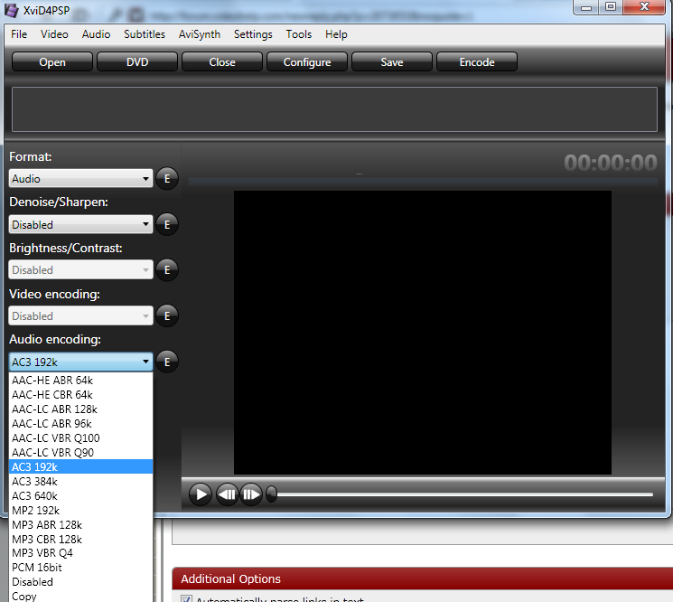

    bottom left of the app you'll see "audio encoding"..i normally choose ac3 192k

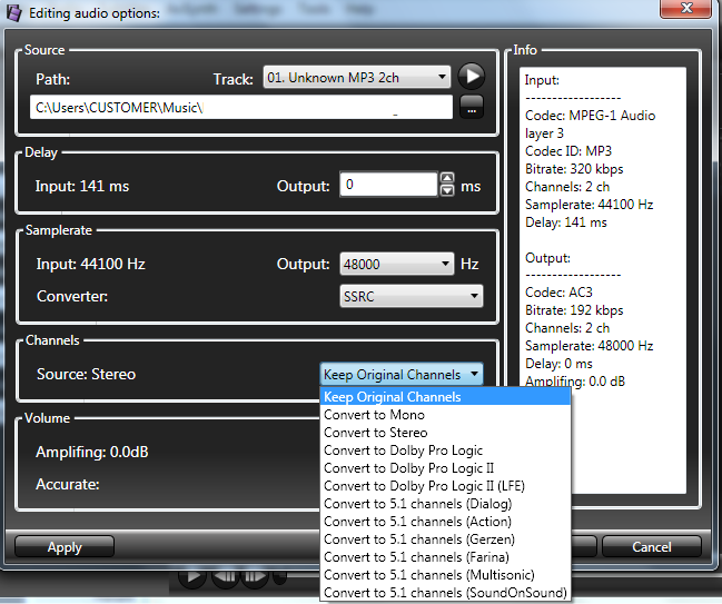

    next...go to the top of the app and you'll see "Audio" then editing options. In there you can keep the 6 channel or downmix to stereo

    it all depends on what you want. The great thing about this little app is that it gives a myriad of options but are really simple to choose from...layman's understanding etc...just have to tinker to see what you like
