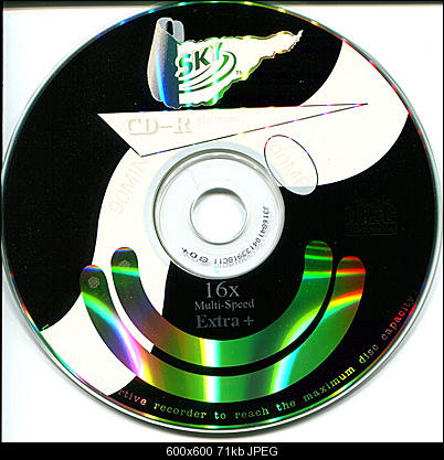

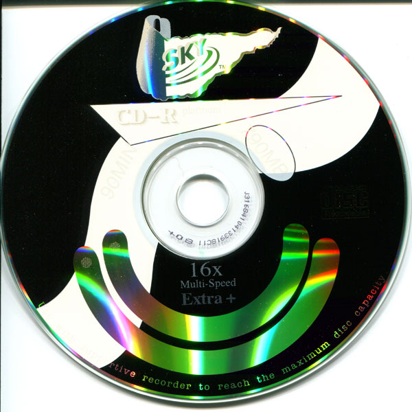

    Has anyone seen a 99 minute compact disc besides online?
    well again you're too late to the party and have too little information. yes they were made, i have plenty i'd give away as they are worthless. IF they don't break your cd burner by causing the laser sled to move past it's designed limit, they played only to the normal size limit on standalones. so the extra minutes of video were lost.
    Yes, here in Hong Kong. Golden Arcade, Sham Shui Po.
    But I can buy a blank DVD for the same price.

    About 90 and 99min CDs: this is almost in the same category.
    It's only by a cheating/stretching of the rules that they are even able to be made, but their bending away from compliance is so much that it is quite likely that machines will baulk at recognizing them correctly. Maybe you've lucked out with your CURRENT burner & reader/player, but what happens when those wear out - will your luck hold out? I wouldn't want to be MY material on such flimsy odds.
