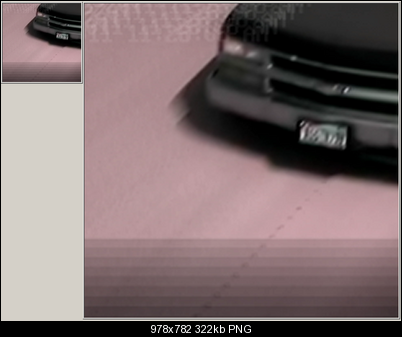

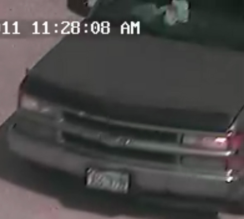

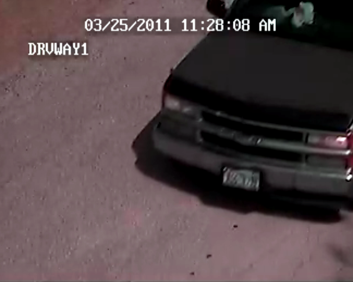

  1. I am trying to enhance this photo to grab the license plate number. This is only a print screen of the original video feed. I do also have the video clip in .264 and a converted .avi format if anyone would be interested. If anyone can suggest a program that will do what I need I would appreciate it greatly. Thank you in advance.
Name:	More of front of car.jpg
Name:	Front of truck with license plate.jpg

    Is this truck stopped or in motion? If stopped and the camera is steady, then better deinterlace plus frame averaging will help make the numbers resolve.

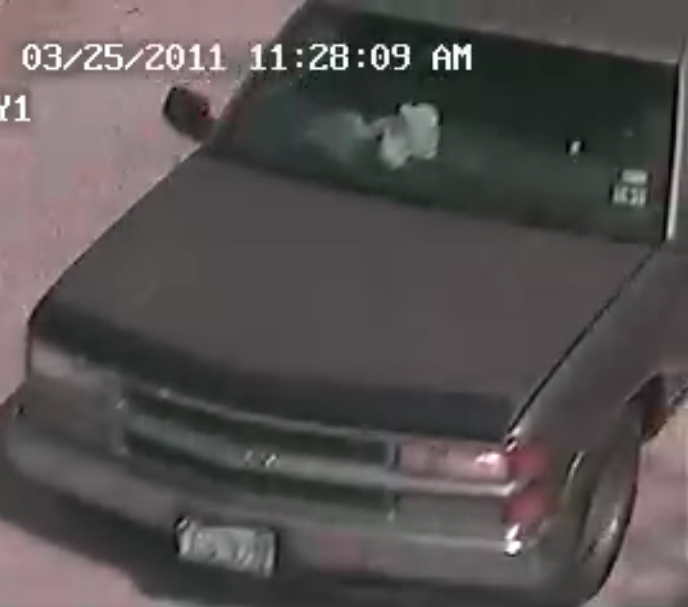

  4. It is a vehicle in motion. The picture is just a print screen from the beginning of the video while paused. I have uploaded the video here. Thank you all for your replies so far.
  5. There is a software called Vreveal (not free) otherwise avisynth might help i guess

    It looks like AS5-1772. Unfortunately I am unable to load the avi into photoshop cs4, I just get a white layer with a film indicator. In this case a in a good video editor adjusting the color levels should clear it up a bit.
  7. This is all great stuff. I really appreciate the replies. I have been working on this for almost a month now and still haven't gotten it yet. AS5-1772 looks pretty close to me but when I look that up in publicdata.com it shows the truck as a ford which this one is a Chevy. Keep up the great posts as it is much appreciated.

    It appeared like AS5-1772 when I adjused the white/black color levels in After Effects. At least, I could import that that there.

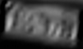

    This is with a levels adjustment

    As5-17772? As5-17771?

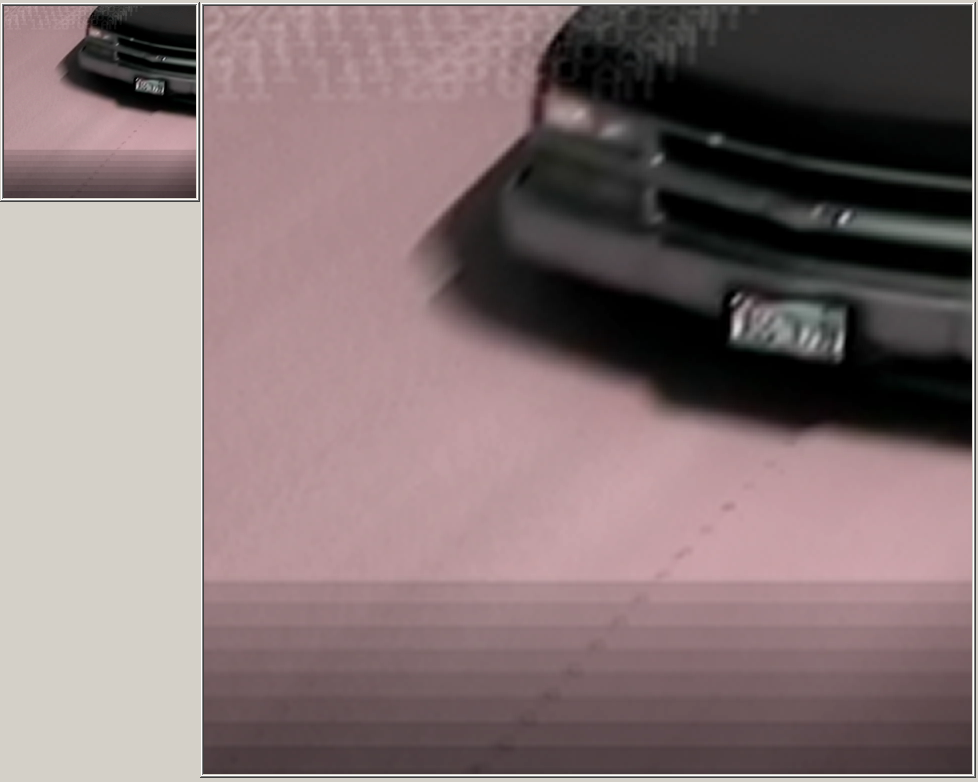

    Adjusted color levels. I wish I had recorded a forensic video on how NASA cleaned up a video taken from an ATM.
  20. I thought I would try tracking the license plate and zooming in with AviSynth's Animate() function. I would then average all the frames together and try an unsharpen mask. But the motion of the plate isn't linear so it wanders within the frame. So I left it after the animate stage, with a little contrast enhancement. I didn't go too far with the contrast enhancement to leave room to fiddle with individual frames. The attached HuffYUV video may help (frame rate slowed to 2 fps)...

    It looks to me like the number may be A54 1723. Although the 1 seems to be too thick so it may be something else. Knowing exactly what all the numbers and letters should look like would help.
    I think there's still hope for the average and unsharpen mask technique, but someone with more patience than me will have to go through the video frame by frame to align the license plate.

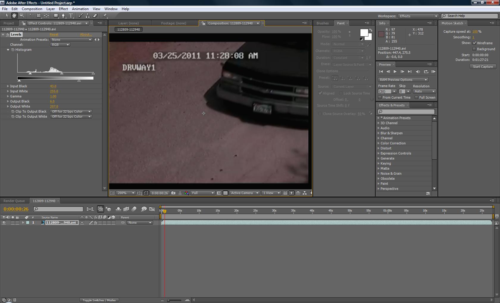

    You can motion track it using AE to align the plate
    The only thing I adjusted was a bit of levels, no other enhancements, sharpening or nnedi3.
    I only included "good" frames. If you wanted some of the distorted frames let me know
    This is RGB uncompressed . Maybe someone can frame average it or do something with it

    Here is a manipulation done in AE on a static frame (not on the motion track clip above) , where I'm moving a shining light below the plate and it embosses the edge to enhance the characters at different angles
    I can only see 5 characters. Looks like 1847H to me . How are you guys coming up with 7 or 8 digits or placeholders ???
    Included is a lower quality animated gif illustration and the uncompressed RGB simulation in the zip file
