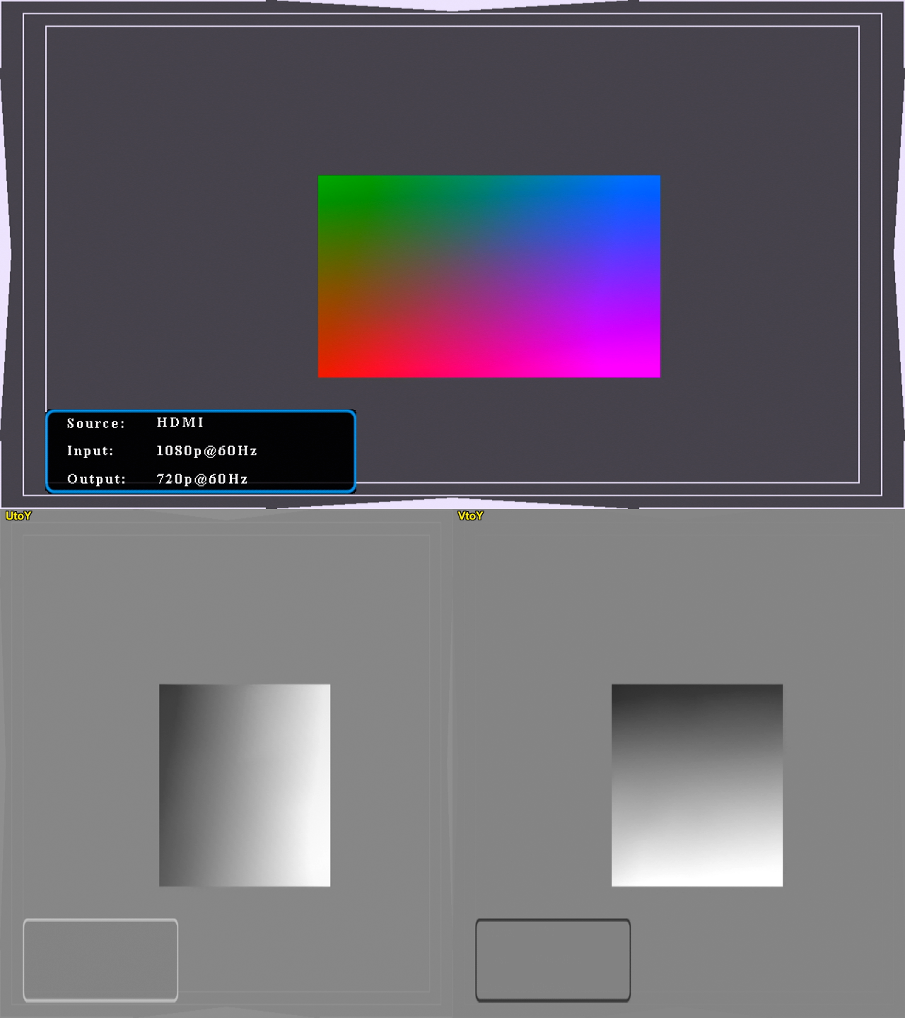

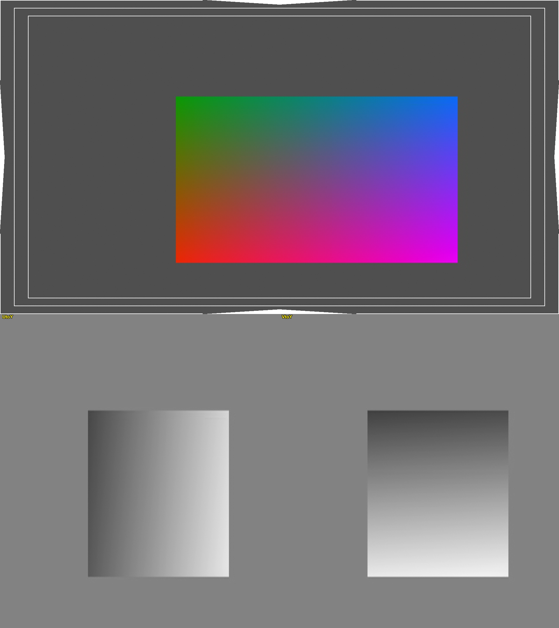

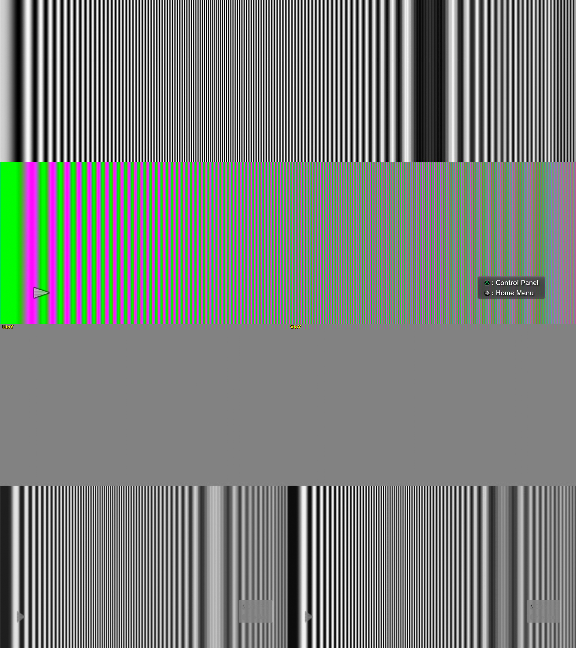

    I don't have a recommendation yet, but I do have a "HDCP stripper" to AVOID.
    My interest was piqued when I came across a broken English translation, and I later found two images associated with the device.
    Adopting HDCP treaty processing technology
    Input can decode, remove the HDCP agreement after HDCP, send out without HDCP HDMI signals, convenient back-end without HDCP decoding display device to receive.
ID:	10636Click image for larger version
    The original name is Playvision HDV-8A, and I've also seen it called T780 (with no company name).
    Website: http://www.hdmi-video.com/en/105.html
    Alibaba blog post with much more info and slides: http://blog.china.alibaba.com/blog/json8/article/b0-i25296920.html

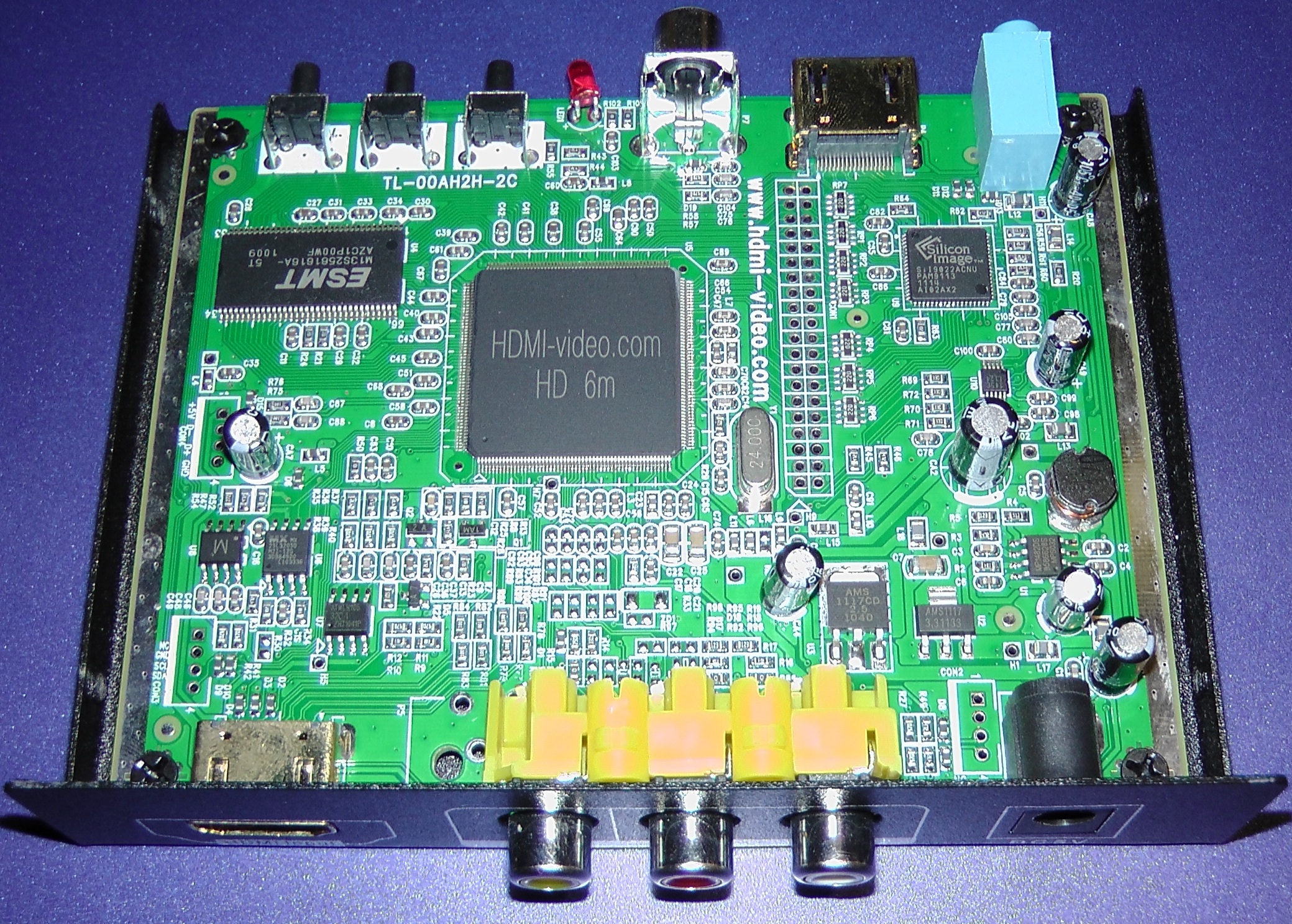

    Here are the internals, for the curious:

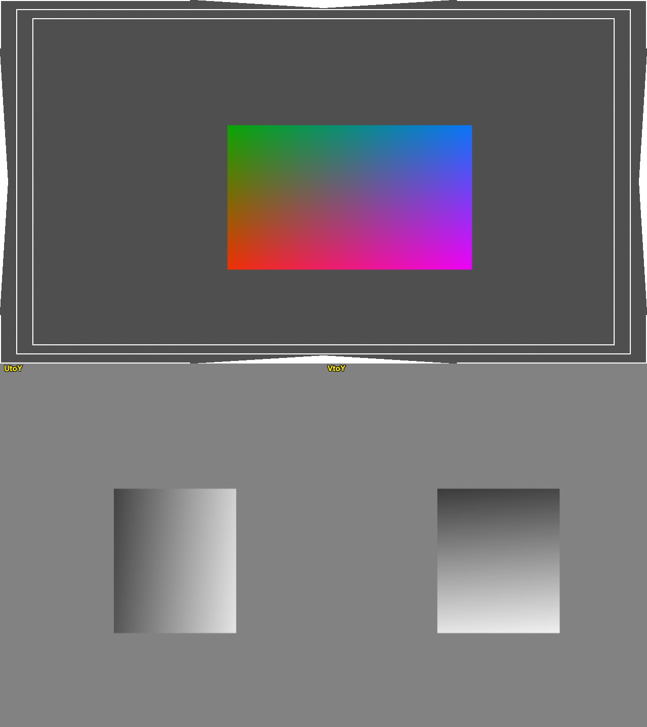

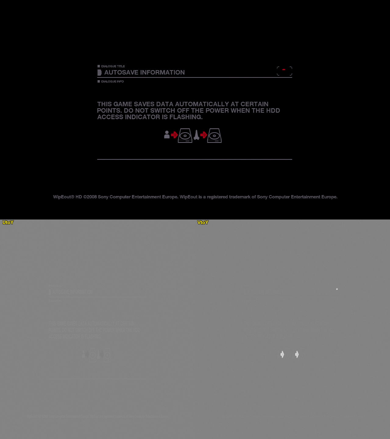

    Most listings including my eBay seller use generic names instead of any manufacturer or model number. The device itself is labelled "HD Video Converter - CVBS/HDMI to HDMI 720P/1080P" and the "User manual" (really a 5-page spec sheet) calls it "AV+HDMI TO HDMI Converter".

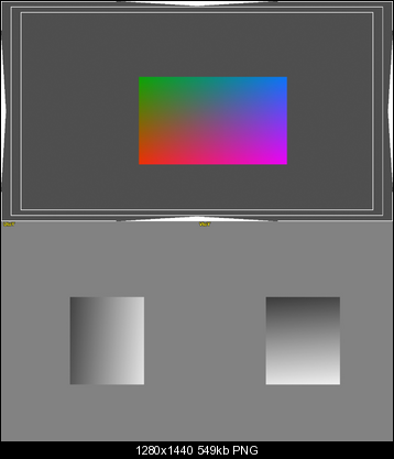

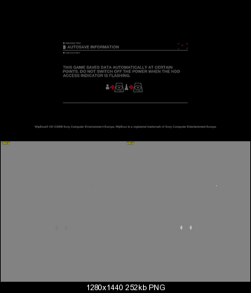

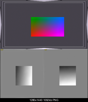

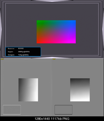

    So, the disappointment. It does take in an encrypted signal and output it in the clear, but not without significant image processing along the way. For all combinations of input and output resolutions, the color is pumped up and tinted. The 60Hz output is always integer 60.00 fps instead of proper 59.94, even when fed with a proper HDMI signal. 720p -> 720p is rescaled instead of being passed through. 1080i -> 720p conversion is blurry. 1080p -> 720p conversion is inexplicably output at 20 fps (each frame is repeated 3 times).
    Screenshots taken with the AVerTV follow.
ID:	10633Click image for larger version
ID:	10637Click image for larger version
ID:	10638Click image for larger version
ID:	10639Click image for larger version

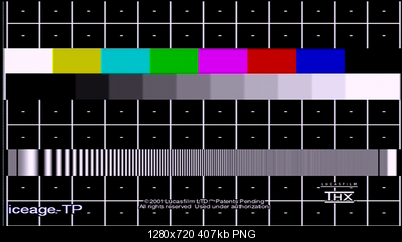

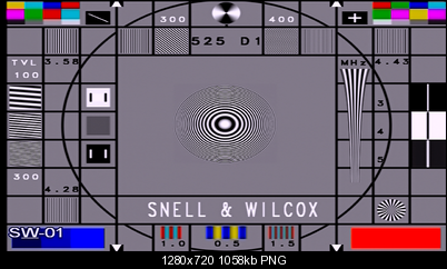

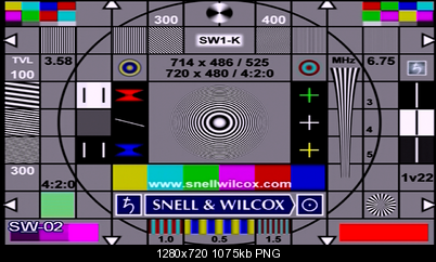

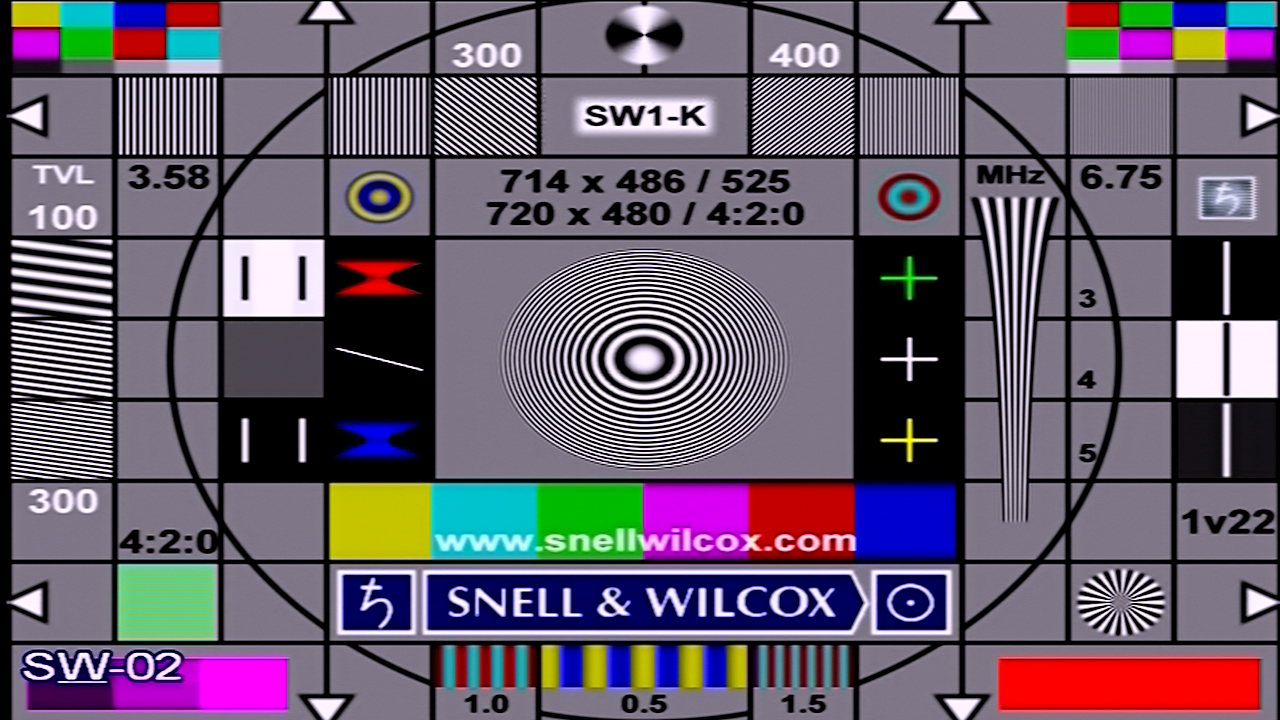

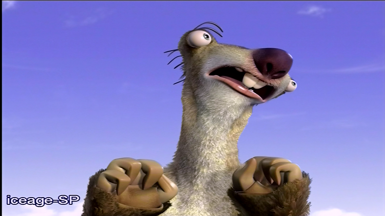

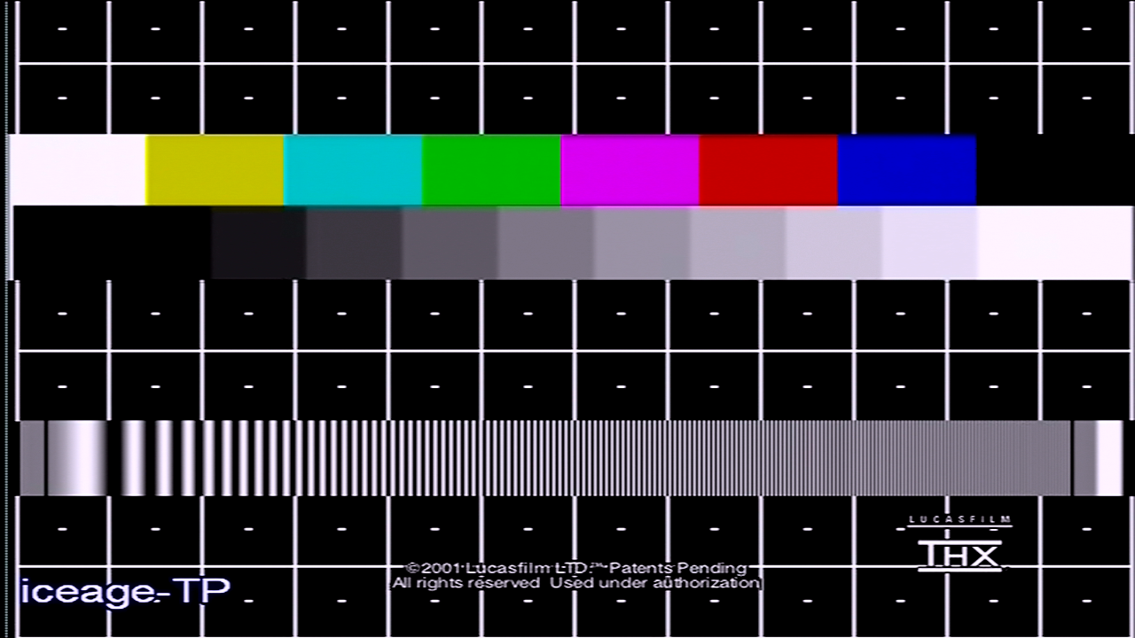

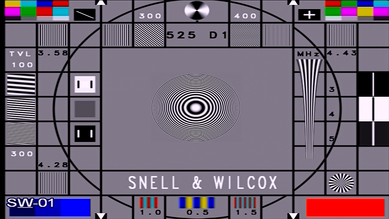

    Composite input (it does have a nice 3D comb filter, but no aspect ratio or any other settings available)
ID:	10642Click image for larger version
ID:	10643Click image for larger version
ID:	10645Click image for larger version

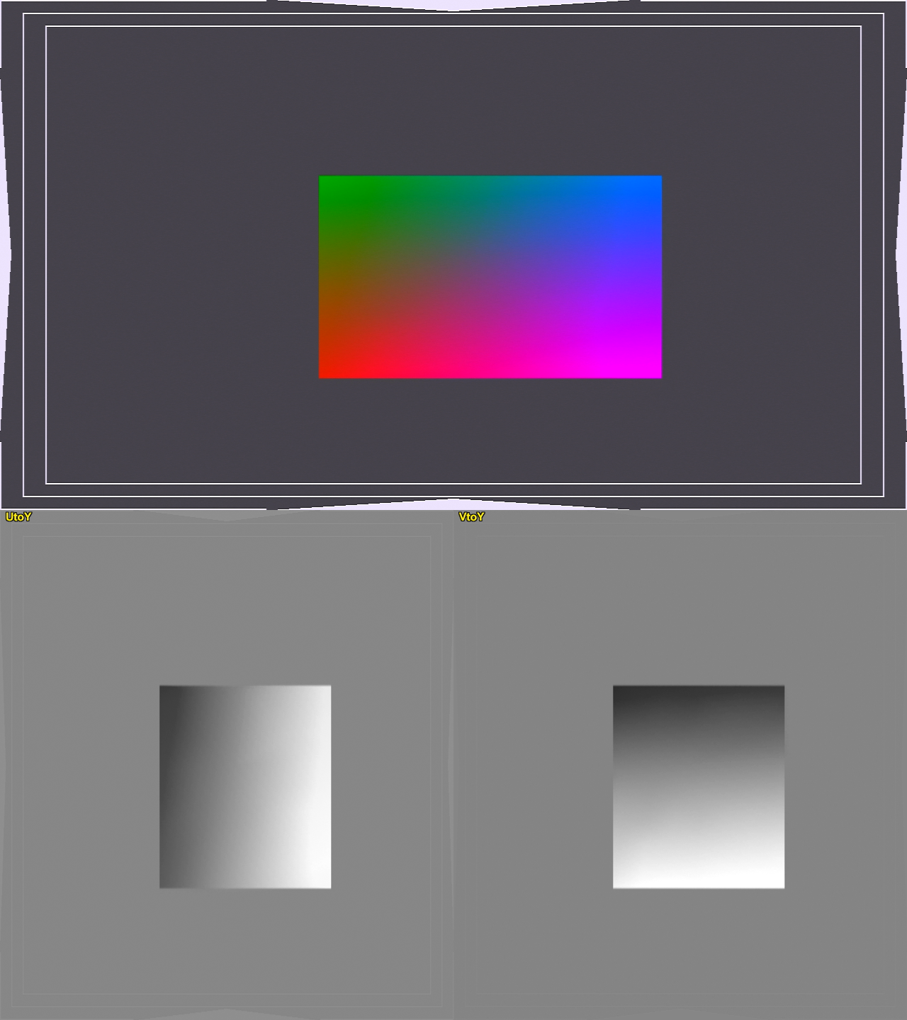

    Got a nice one that includes HDMI in/out for $83 with shipping and tax. If you're a US resident you could probably buy it for $70 all in, maybe less if you really shop around.
    I'd rather not publicize what it is to random surfers who happen through, so look for a YouTube video by the username rxmako. You can PM me for more info if needed. I went with option #2 in his video because I didn't want to be forced to run an optical cable from any source I may want to hook up. If you don't mind doing that, you could be stripping HDCP for under $50.

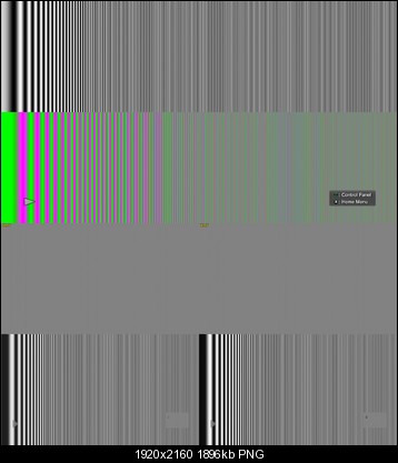

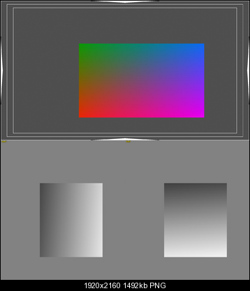

    Downsides to this box:
    - physical size (10 inches wide)
    - 480p passed through it gives a garbled image on the AVerTV (yet looks fine on my TV...)
    As you can see the image quality is not impacted with this device.
    720p game image (compare to post above)
ID:	10704Click image for larger version
ID:	10706Click image for larger version

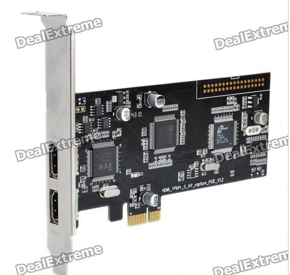

    It is a Avermedia Capture HD clone. There are modded driver that ignore HDCP content for Avermedia card.
  8. Originally Posted by danno78 View Post
    Originally Posted by steelahlive View Post
    OLD FORUM I know - but figured I'd do my yearly check to see if anything had come about. I did through a lot of google searching find this posting in another forum about a Black Magic Intensity Pro (Clone) with HDCP Chip installed onboard. Wanted to throw this out there to some folks....wondering if anyone has used it.
    http://forums.redflagdeals.com/dx-hdcp-bypass-capture-card-spotted-wild-cheap-133-60-f...pping-1212100/
    I cannot verify the integrity of the post nor the device.
    v/r
    Steel
    I see, so? Is it worth it? Either the original with hacked FW drivers or the clone with onboard HDCP chip?
    May 2007
    Romania

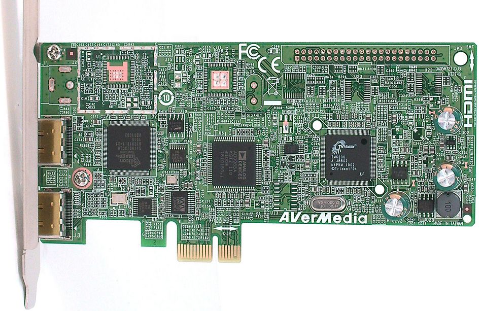

    The hardware is almost the same on both. The chip which handle HDMI in the clone come from ITE and for Avermedia come from Silicon Image. If the clone is chepear then is worth. In my area the original is cheaper.
    Here are reports that with some drivers (original drivers from CD) Avermedia work with HDCP content:
    https://forum.videohelp.com/threads/341920-Need-Original-Drivers-for-Avermedia-AverTV-H...DVR-%28c027%29
