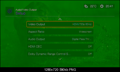

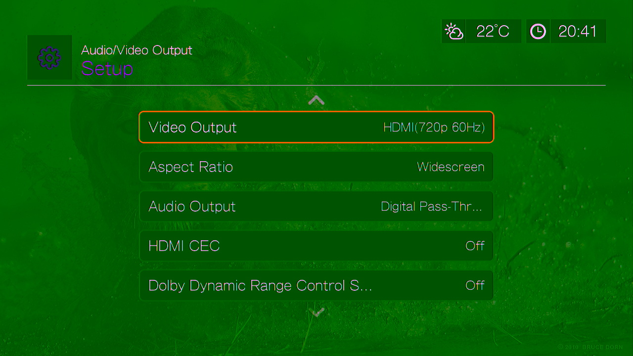

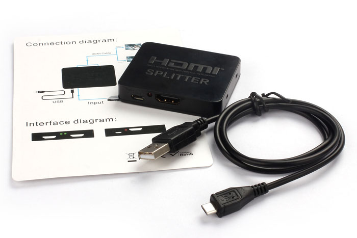

    I purchased one of these tiny splitters from eBay way back on Jan 18 for $7.32 shipped from "bessky_store". This particular listing was called "Hottest View HD HDMI Switch Splitter 1 Input to 2 Output 1x2 in mini Case".
    I can't remember whether I've seen other posts about this particular model anywhere. For me, it does properly strip HDCP from my PS3 and protected sources on my WD TV Live. I tested with the Intensity Pro 4K and my Samsung HDTV as the outputs, with the splitter being powered only via HDMI.
    All's well with RGB output. When I switch to the WD TV Live's YCbCr mode, I get this weird green-tinged output. It also happens when the splitter is connected to only the TV, or only the capture card, so it's not specific to either of those devices.
Name:	HDMI mini splitter - YCbCr weirdness [IP4K TGA].png
    It happens with every resolution I tried (1080p, 1080i, 720p, 480p, all @60). Sometimes when changing resolutions, rather than the green video, my TV would just show its "Mode Not Supported" error screen. Unplugging and replugging the HDMI cable at the splitter's input jack is sufficient to clear both issues, but the problem sometimes reappears on its own when an EDID negotiation happens, necessitating another unplug-replug cycle. One example is exiting the WD TV Live's Netflix app: it goes from HDCP mode to unprotected mode, and when I exited, everything went green.
    I tried plugging the USB cable into my TV to see whether providing power that way makes any difference, but the results were the same (I'm not actually certain its USB port can provide sufficient power mind you). The seller offered to send another one, but that replacement never arrived, so I dunno whether another unit would suffer these faults.
    For the price and the convenience of using no separate power source, I'm happy with it even with this annoyance. But I won't be getting rid of my reliable VHD-1x2MN3D.
    (I'd open it up to take photos of the chips, but there are no screws and I think I'd end up breaking plastic clips if I tried.)

    When my card acts up, similiar to that, I reinstall the card...or maybe I misunderstand and you are not using a card???
  24. Originally Posted by vaporeon800 View Post
    Have you tried completely disconnecting all the HDMI cables to "reboot" the splitter?

    That wasn't specifically my intention, but yes I ended up doing that a couple times and there was no change in behavior. At one point the splitter was sitting disconnected on my table for months before I plugged it in and saw the same thing upon switching the WD TV Live to YCbCr.
    Connecting the splitter to my battery-powered HDMI camcorder, I found that it failed to pass any signal above 480p until I also plugged in the splitter's USB power connection. Then 720p, 1080i, and 1080p all worked fine. (All in RGB; no option to force YCbCr.) I guess it makes sense that a battery-operated device would try to use the minimum power necessary for a regular HDMI connection.

    I work with a lot of low power microcontrollers and some can pull enough power from signal pins to run the part even without power applied to the power input. I was speculating that the MCU entered an unstable state and that disconnecting the HDMI cables would reboot the chip, getting it back to stability. Guess not.
