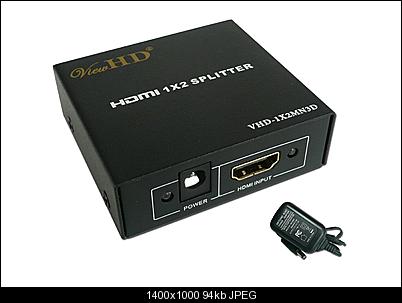

  27. I have the unit pictured here .
    The internal chips are Silicon Image (SiI9187) and Pericom P13HDMI412AD, plus one more that is completely unmarked.
    How can I test it to see if it is compatible with an HD-PVR2 before I make the purchase of of the HD-PVR2? Is there any other way to identify if this is working as required?
  28. Member SHS's Avatar
    Oct 2000
    Vinita, Oklahoma
    What about it, It just same as on mine ViewHD very same set chip the completely unmarked chip is the firmware or HS07 I think which works just fine on my HD-PVR Rocket
    Update just finish testing HD-PVR 2 and works and so dose the Colossus
