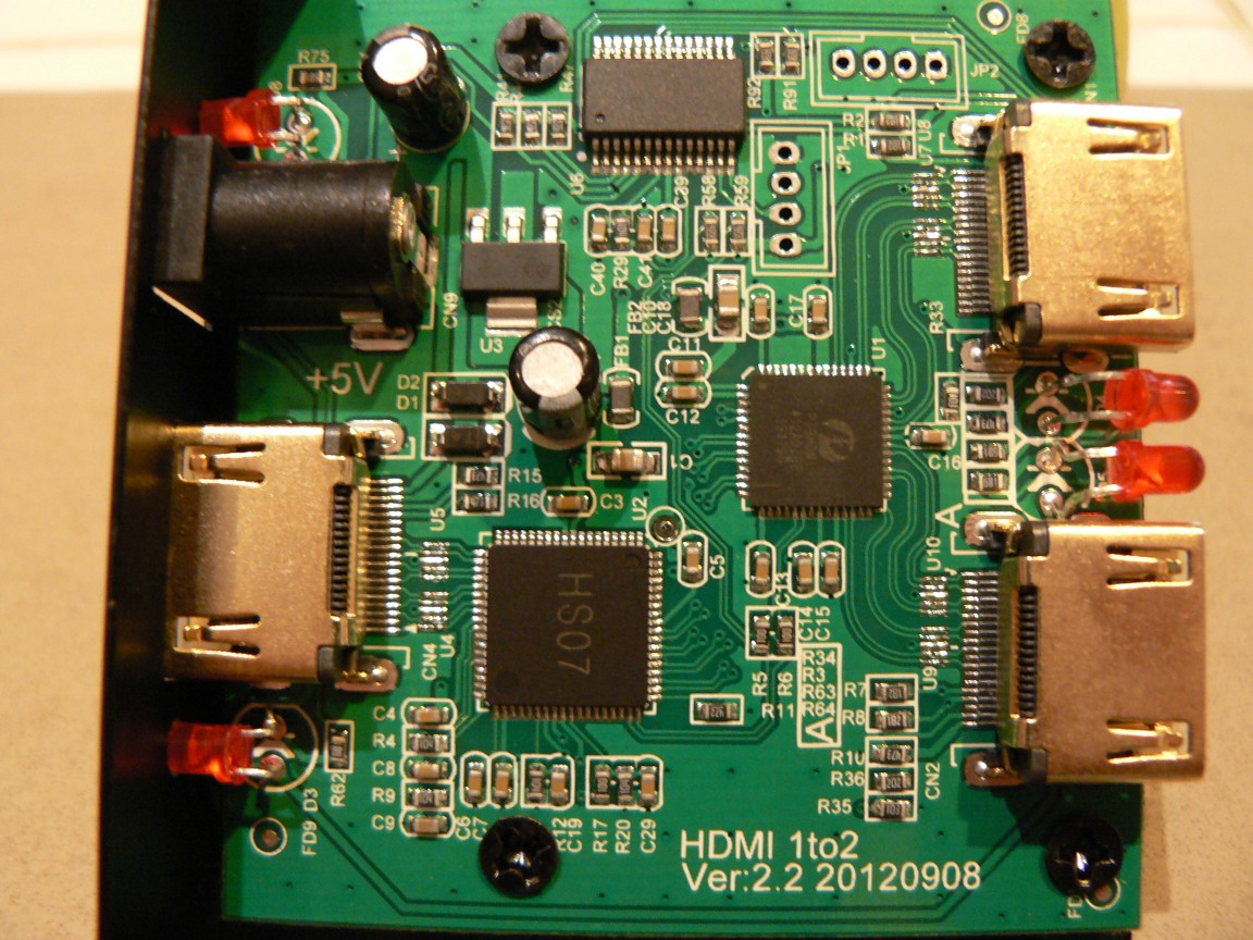

    Another successful story with a "mini HDMI2HDMI " adapter from AliExpress http://www.aliexpress.com/item/Hdmi-decoder-hdcp-separator-digital-signal-converter/1272877644.html
    HDMI in IC
    HDMI out IC
