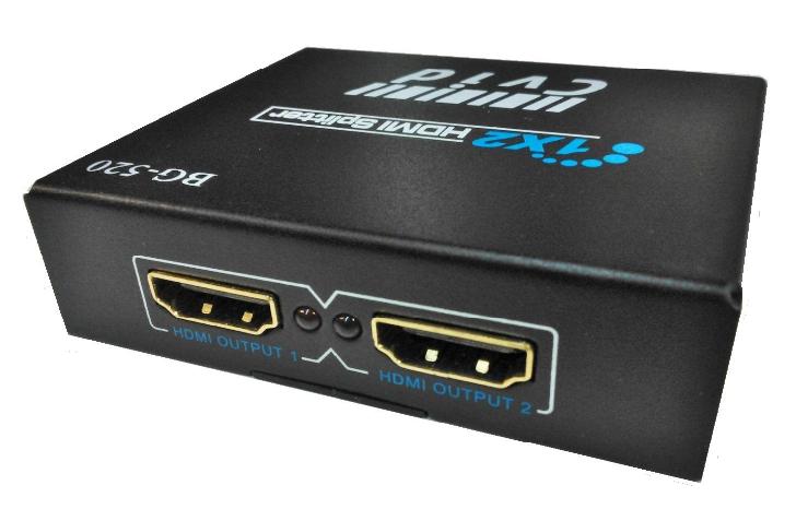

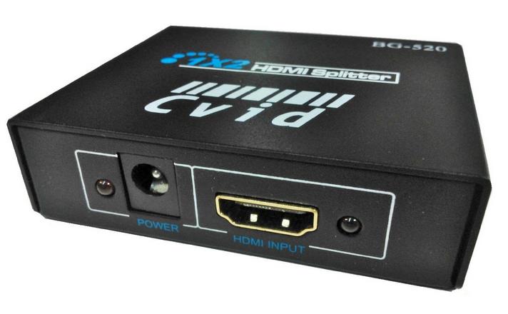

  16. Just to confirm others' observations: I bought the CVID BG-520 1x2 HDMI splitter and it successfully removes HDCP. Just like it's 1x4 big brother I purchased before.
    http://www.amazon.com/gp/product/B0089DSLMY/
    The listing now shows "Ships from and sold by Amazon.com" but when I bought it the seller was Great Elect.
  17. Formerly 'vaporeon800' Brad's Avatar
    Apr 2001
    Vancouver, Canada
    Naked pics of it please!
    Are you able to capture 480p okay?

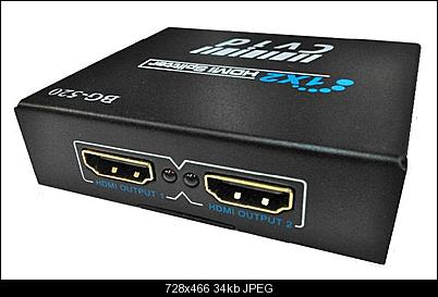

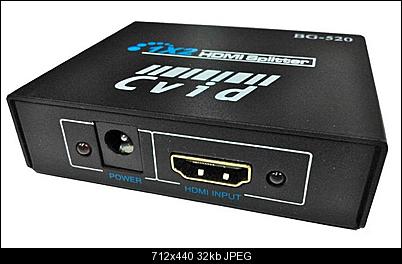

  18. It looks exactly like the pictures at amazon except it doesn't have the CVID logo or the model number printed on the top, just the "1x2 HDMI Splitter" Pictures from Amazon:

    I'll see if I can capture 480p with it later. I've only tried 1080p60, 1080i30, and 720p60 so far.

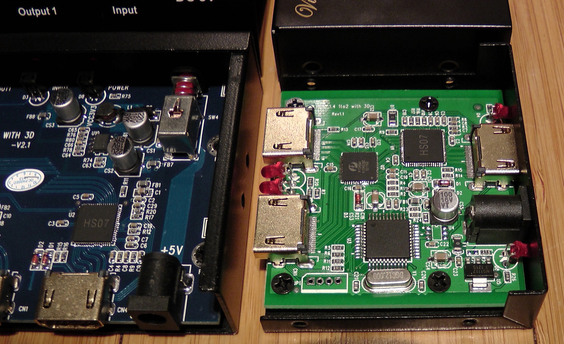

    Mine that looks the same as what you describe on the outside, ordered at the end of 2010, does not strip HDCP. Yours is different and supports 3D.
    http://www.avsforum.com/t/1315847/cheapo-active-hdmi-1x2-splitter-my-review
    Can you try 480i30 as well if it's not too much trouble?

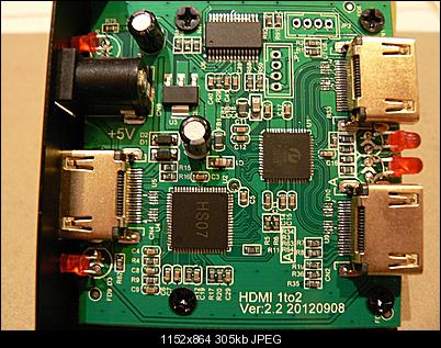

  23. Oh, I thought "naked" meant you couldn't see the Amazon page for some reason and wanted just the pictures uploaded here. I'll see if I can take it apart later.
    OK, here's a picture of the inside. It's different than yours:

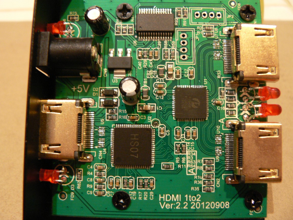

    Thanks for the photo, jagabo.
    The basic layout of your Cvid BG-520 board matches the ViewHD VHD-1X2MN3D and the two main chips appear to be the same. Third one is smaller on yours, and there are a bunch of little changes. The ViewHD is labelled as being an older Revision.
