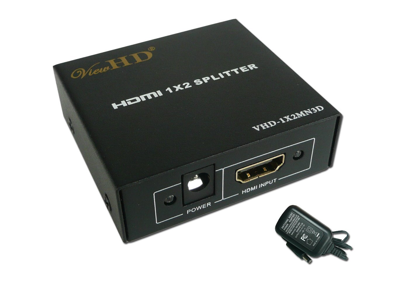

  1. Hi again,
    Has anyone had experience with this: http://www.amazon.com/ViewHD-Premium-Matrix-Digital-Surround/dp/B0031SWDKI
    Does it strip HDCP? Because if so that would be perfect for me.

    This similar model does not: http://m.aliexpress.com/item-desc/758285698.html
    Maybe this "2013" ViewHD with 3D support does. The remote certainly looks different.

    I opted out for the ViewHD 1X2 HDMI splitter. Hopefully this works for me. I would also like to try to upconvert VHS tape output looped through my Pioneer DVD recorder since it has good up conversion and record that HDMI output to the HDPVR2 to see how that looks. Anyone tried to do something like this or output a DVHS with up conversion ability to the HDMI input? Results?

    For the price in that eBay listing you could afford to buy three 1x2 splitters and bring two of them to the recyclers.
    With DVI+SPDIF to HDMI you:
    • are limited to 2-channel PCM or 5.1-channel compressed
    • need a device that outputs Toslink
    • have to run an additional cable
    Meanwhile, I bought one before with model number HDCDVI0101 that does not strip HDCP.

    This one is the holy grail of HDCP strippers for me, since I consider a powered splitter to be a requirement in any HDMI capture setup anyway and I want the smallest one possible.
    Purchased from the above Amazon.com link on 4/16 for $25.90 with shipping to Canada. Shipped from 95763 on 4/17 and it arrived 5/08 (the tracking claims that it took 7 business days to get from LA to customs). It works as expected.
    The photos are accurate (unlike the CVID, they did bother to add their logo onto it). Though the power adapter I happened to get is better than that (horizontally-oriented so it doesn't cover another outlet). The LED colors are all red. While the listing says "HDMI 1.3 + HDCP1.0/1.1/1.2", the circuit board says "HDMI 1.4 1to2 with 3D".
    [Attachment 17730 - Click to enlarge]

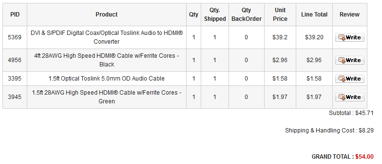

  25. glad to see you got it to work but i wanted to share too..
    just to start i didn't read through all 11 pages of this thread, but i just want to say i use one for hd pvr 2 with my ps3 so i could record via hdmi.
    first here is the equipment need:
    i ordered everything from monoprice.com
    here is a video on my set up : http://www.youtube.com/watch?v=adxWdkdTlr0
    its kinda of half fast. sry
