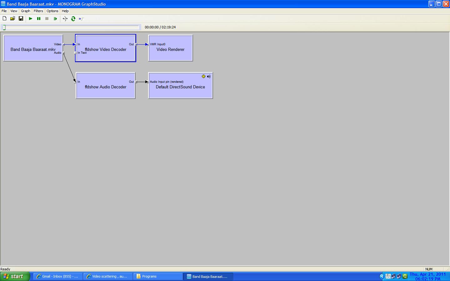

    Try playing the files with graphstudio, available from the tools section on this site.
    At least it will show you the directshow chain and see what filters you're getting

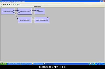

  9. Yes I having difficulty with HD video (1080 or 720) only , other files plays normal , But Still the files not playing on my PC plays normly on my another PC , by using graphstudio i got information I have posted the image but what to next I dont know what to do , As I said while playing CPU use is normal not so high and no any interference of antivirusClick image for larger version

    Try reinstalling ffdshow and haali splitter. If it doesn't help, perform a clean boot and see if it re-occurs.
