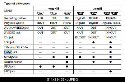

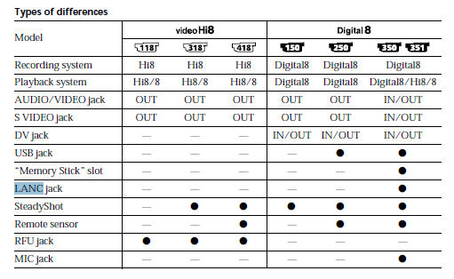

    seems that model has neither a lanc jack or remote control sensor built-in. from your manual.
