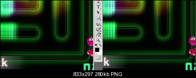

    Yeah, probably should have gone ahead and done that. (Click to enlarge.)
    On the left, interlaced. On the right, deinterlaced only with AE's field separation. As described, the vertical lines are apparent in the fine (green) color gradient (it's also apparent in all other colors, not just green), but it's well hidden in the interlaced image, although objects in motion obviously exhibit interlace artifacting.

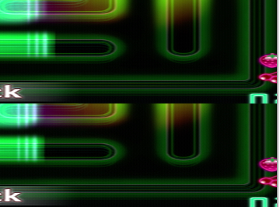

  6. The vertical lines are already in your source, you can see them if you look at individual fields
    here is your "original" , cropped, then fields separated, and stacked on top of each other
    I think because the "black/white" are offset in each consecutive even/odd field, they essentially cancel each other out when looking a single interlaced frame
    But when you deinterlace, each field becomes a frame (+/- other processing like antialiasing), so the vertical bands become readily visible
    You should take closer look at your capture card and the workflow

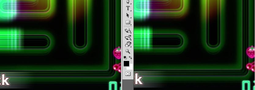

    You can probably improve it with some filters
    e.g. Left is your AE sample, Right is the "original" processed
    But I need to examine temporally, and how pattern behaves over time - Can you post a video sample?
    But it would be better if you could fix it upstream before the capture (less processing, less quality deterioration)

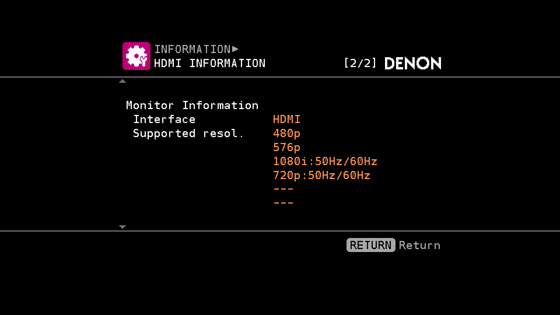

    The card doesn't cause lines on a black background. Does the Xbox have a photo viewer or something you could use to test?
    And an image that was converted from the PS3's RGB output by the card: http://img51.imageshack.us/img51/8986/cinaviamute.png
    I don't feel like hooking it up at the moment and I don't have an Xbox so hopefully these suffice.

    pm_sv2t3_xp_yv12torgb.avi
    These oddities are definitely not in the pre-ConvertToRGB version (already deinterlaced and DeStriped). I enhanced the levels to make certain. The alternating nature of the phenomenon is particularly baffling to me since the video is no longer interlaced.

    I plugged that line in to see what it would do to the image. Seems pretty destructive (overall gamma appears to be raised for some reason). But the most odd thing is that it generates unusual behavior in the chroma channel. Observe the moving hamburger or the digit which changes from 7 to 6 in this extremely short clip:
    Did you make that with VirtualDub? Taking an interlaced YV12 source and making an RGB clip? If so, that's VirtualDub's fault. It doesn't handle interlaced YV12 chroma channels correctly. Convert to RGB in AviSynth before feeding VirtualDub: ConvertToRGB(interlaced=true). Or maybe you did a conversion in AviSynth and neglected so specify interlaced=true.
  30. jagabo , I think he added that after the script (ie. after deinterlacing, after destripe etc...)
    To me it looks like a frame misorder mixup with temporal filtering, or memory flush issue
