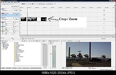

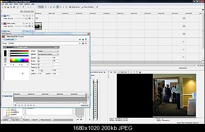

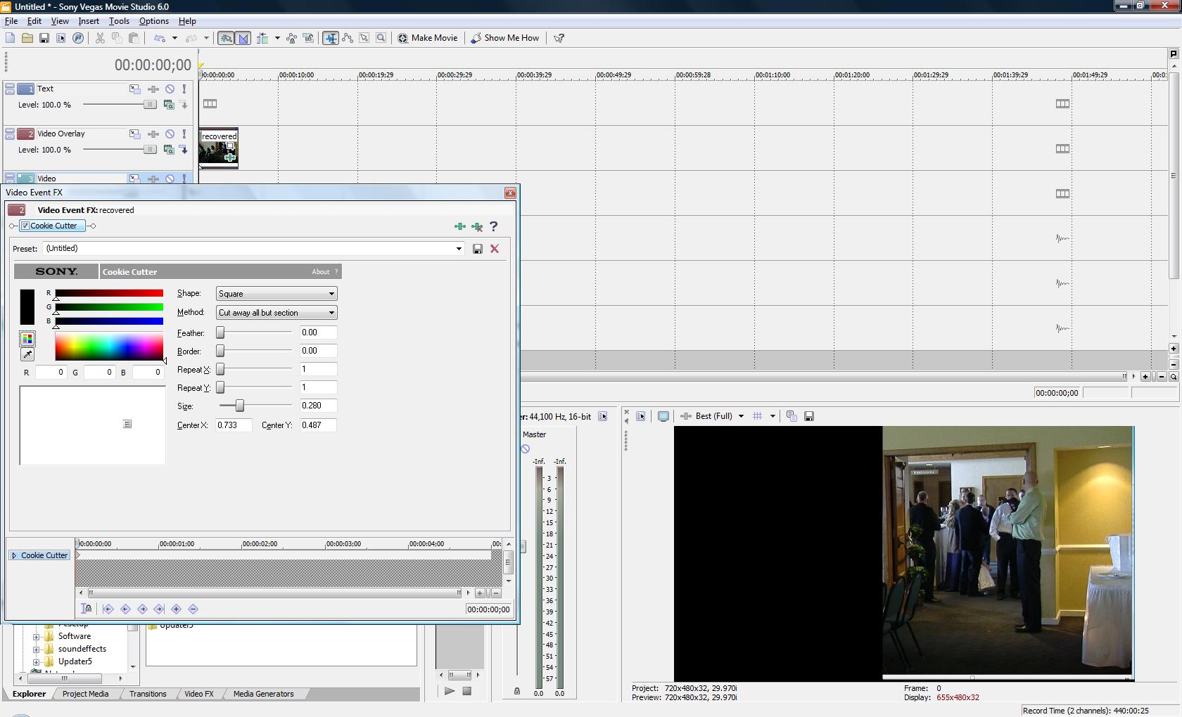

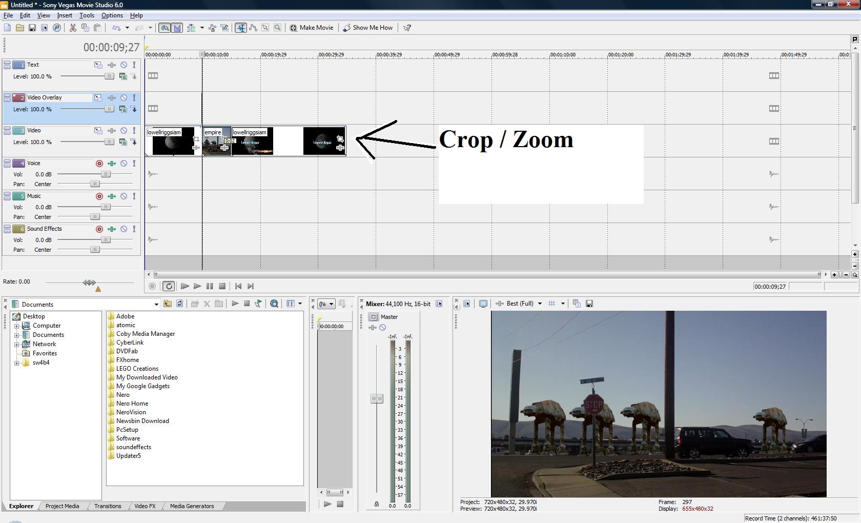

    Thank You! One last thing. Does anyone know how to crop a certain part of a video? Like lets say we have a video of Guitar Hero. How do you crop it so that the clip is only showing the person playing and leaving everything else around him out? Like I want to use only the right side of a certain clip. How do i go about doing that? Thanks everyone!
    Feb 2008
    Twin Peaks
    For simplicity purposes use the cookie cutter.

    Or use the crop / zoom event (the diamond looking marker)
