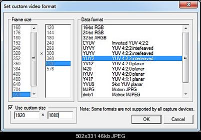

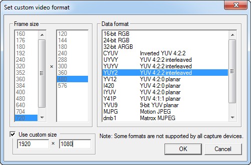

    Alright. Seeing as how people have specifically recommended using VirtualDub to capture 1080i from this card, I suppose it's a matter of tweaking something in the driver - something that is absolutely missing from the setup software provided by AverMedia. The AverMediaCenter software does at least recognize the 720p input for what it is.
  5. While capturing try Video -> Set Custom Format. At the bottom of the dialog tick "Use Custom Size" and enter the dimensions.

    You don't have to set a custom format; just Video -> Capture pin.

    Cauptain, nice video, but no need to set the Custom Format if you're setting Capture and Preview pins manually anyway.
    Other than that, Asterra, make sure that you set the framerate to match the input source, or it will drop frames in an irregular pattern. If you want 29.97 from 720p59.94 you need to capture all the frames and remove half in post.

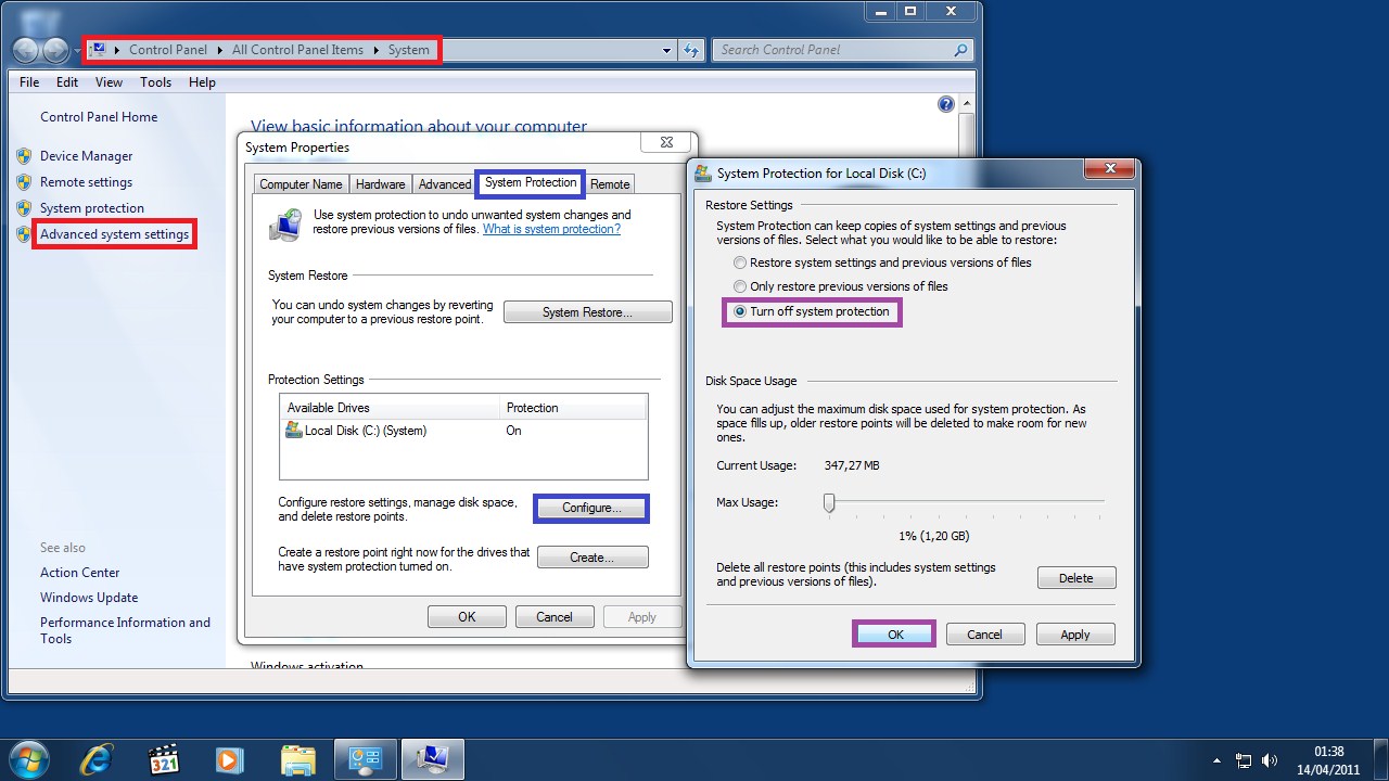

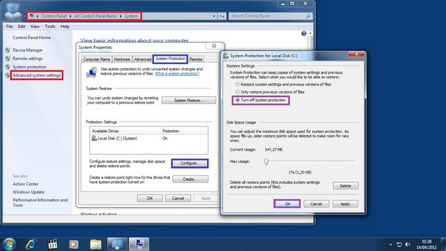

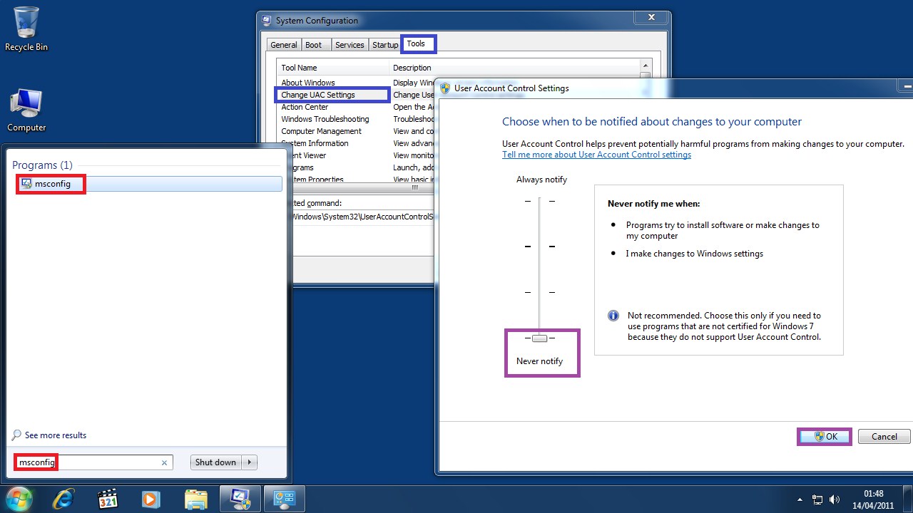

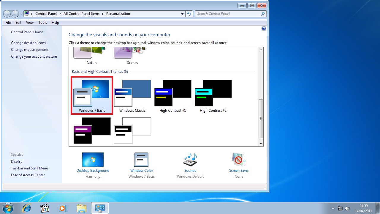

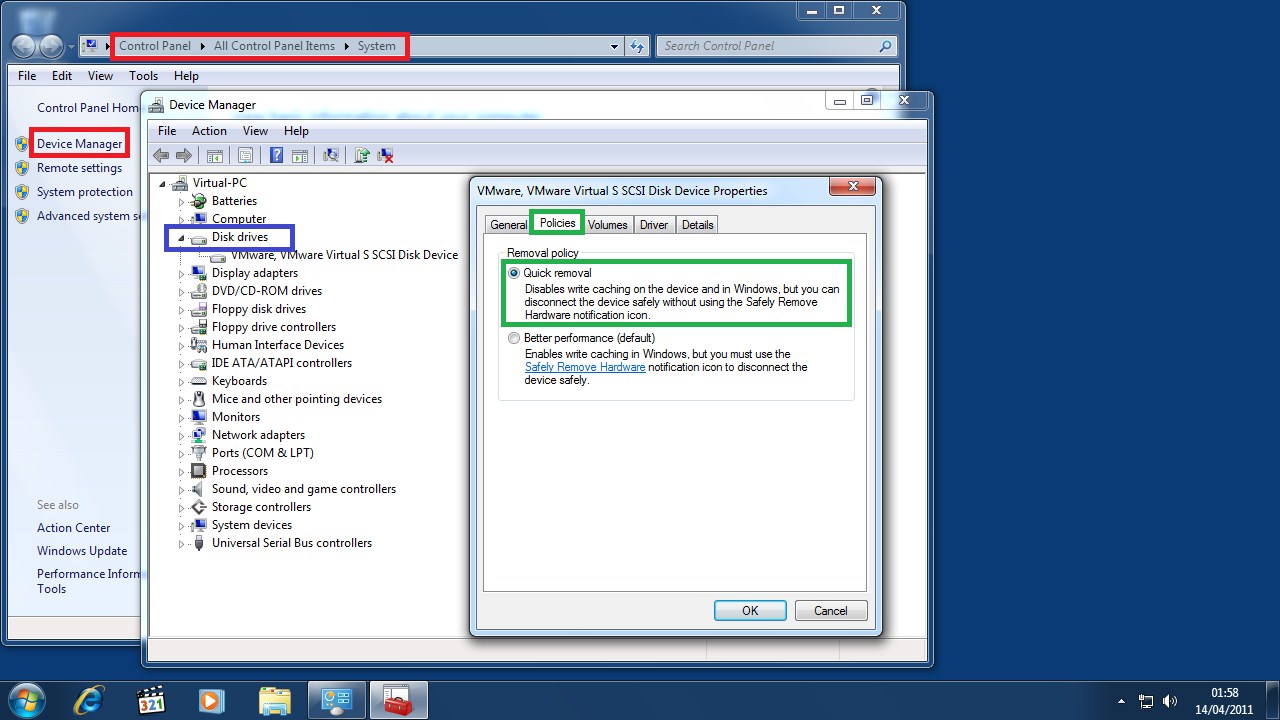

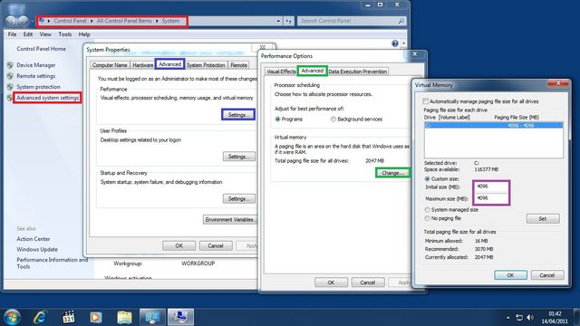

    Try my settings to PC RECORD VIDEOS:
    Reboot your Pc after make changes.
    Disable your antivirus when recording.
    After tests post the results.
    Claudio

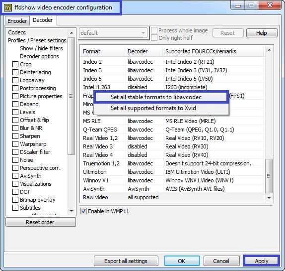

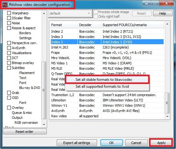

    Simple. Enable FFDSHOW to this. Look:
    Claudio

    Cauptain - The fix for this was that I installed the x86 version of that Codec as well!
