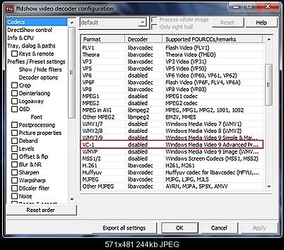

  3. FFDSHOW --> Video decoder Configuration. Click "Codecs" upper left, then in the right-hand pane scroll down to VC-1. Double-click the decoder being used (second column). A drop-down list will appear. Select "WMV9", apply, okay, exit.

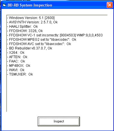

  4. Thanks Fritzi93! After following Baldrick's link to the inspector, I came across this window which appears to tell me the same thing in a different manner. I've made the change, so hopefully we're good to go now!
Name:	Inspector screenshot.JPG

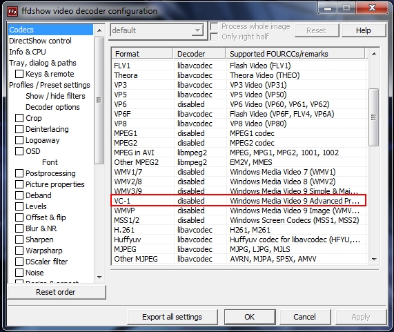

  6. Enable the VC-1 to libavcodec.

  7. What happens if you enable the internal LAVF decoder?
    Anyway, it's not even starting, it's bombing out immediately, which makes me suspect the splitter is the problem. I'd try uninstalling Haali, manually deleting the Haali folder, and run a registry cleaner like CCleaner. Then reboot and re-install Haali. It may have been corrupted. Re-installing to a corrupted folder practically guarantees the problem won't go away. Surprisingly common problem. And if you have a codec pack installed, get rid of it and run a registry cleaner.
    The WMV9 setting for VC-1 should work if everything else is okay.
    If the above doesn't do it, start over with *all* the helper apps. Again, no codec packs.
    Good luck.
    Pull! Bang! Darn!
  8. It seems to have worked after dylz's suggestion of changing the VC-1 to libavcodec. I'm actually on the road for two weeks and am doing the converting via remote desktop at the home PC (ripped off a bunch to the hard drive before I left so I could experiment remotely) so I can't really "test" how a burned copy looks/plays, but no errors at all with the BD-Rebuilder in this mode. Strange?
