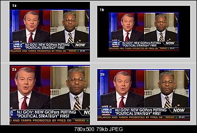

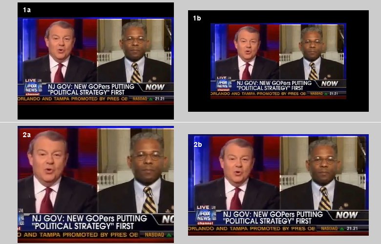

    Actually it can. If a program is created/produced in 16:9, there are a number of ways the video can be formatted for digital SD distribution, including:
    1. 16:9 source can be pre-letterboxed at the studio within a 4:3 frame (see image 1a)
    - downside is that on some 16:9 TVs, the image may end up 'pillarboxed' and look like example 1b unless the viewer changes their TV's settings.
    - another disadvantage is pixels are being wasted/used up by the black bars leading to lower vertical resolution
    - advantage is that 4:3 viewers can be forced to watch letterboxed
    2. 16:9 source can be transmitted as anamorphic video (image 2a/2b)
    - downside is some 4:3 viewers may have their TVs set to 4:3 CCO and not see the edges of the frame (2a).
    - graphics placement might be limited to the central part of the frame to avoid cropping text for 4:3 viewers
    - advantage is that it should be formatted properly on 16:9 displays (2b) and have a higher vertical resolution.
    For example when Fox News first switched to 16:9, the channel was pre-letterboxed (example 1a). But they've recently switched to anamorphic widescreen (2a/2b).
    The introduction of 16:9 has added complexity to TV production, distribution. It was easier 10-15 years ago when TV was almost exclusively 4:3.
