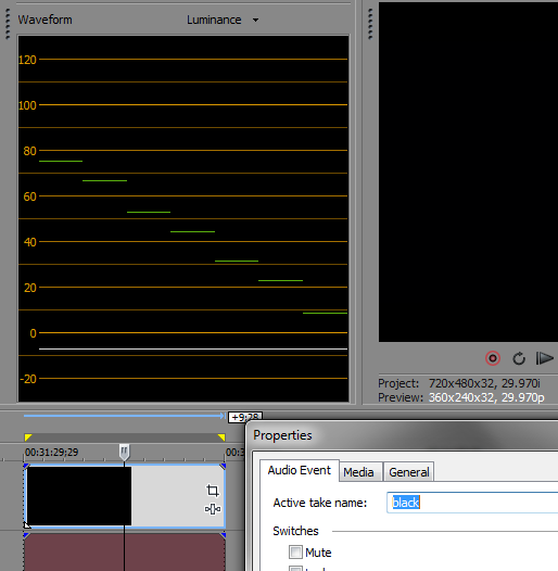

    I just rendered 10 seconds of black using Mainconcept in Vegas, which seems ok on my system. How does it appear to you? What are you using to judge the "blackness"?
    Your black is at digital zero, not 16.

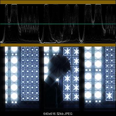

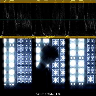

    Waveform levels graph of sample h264.avi (correct):
    Waveform levels graph of sample - mainconcept.m2t (incorrect):
    The waveform should not extend into the brown/yellow areas of the graph.
    The actual video image in those two pictures have been adjusted for display. Ie, they have gone through the normal contrast stretch that any media player (including Blu-ray and DVD players and TVs) should perform when playing the videos. Notice how the details on the characters shirt have disappeared in the mainconcept encode.
    The mainconcept video is encoded incorrectly. It looks better on your computer because your computer is maladjusted.

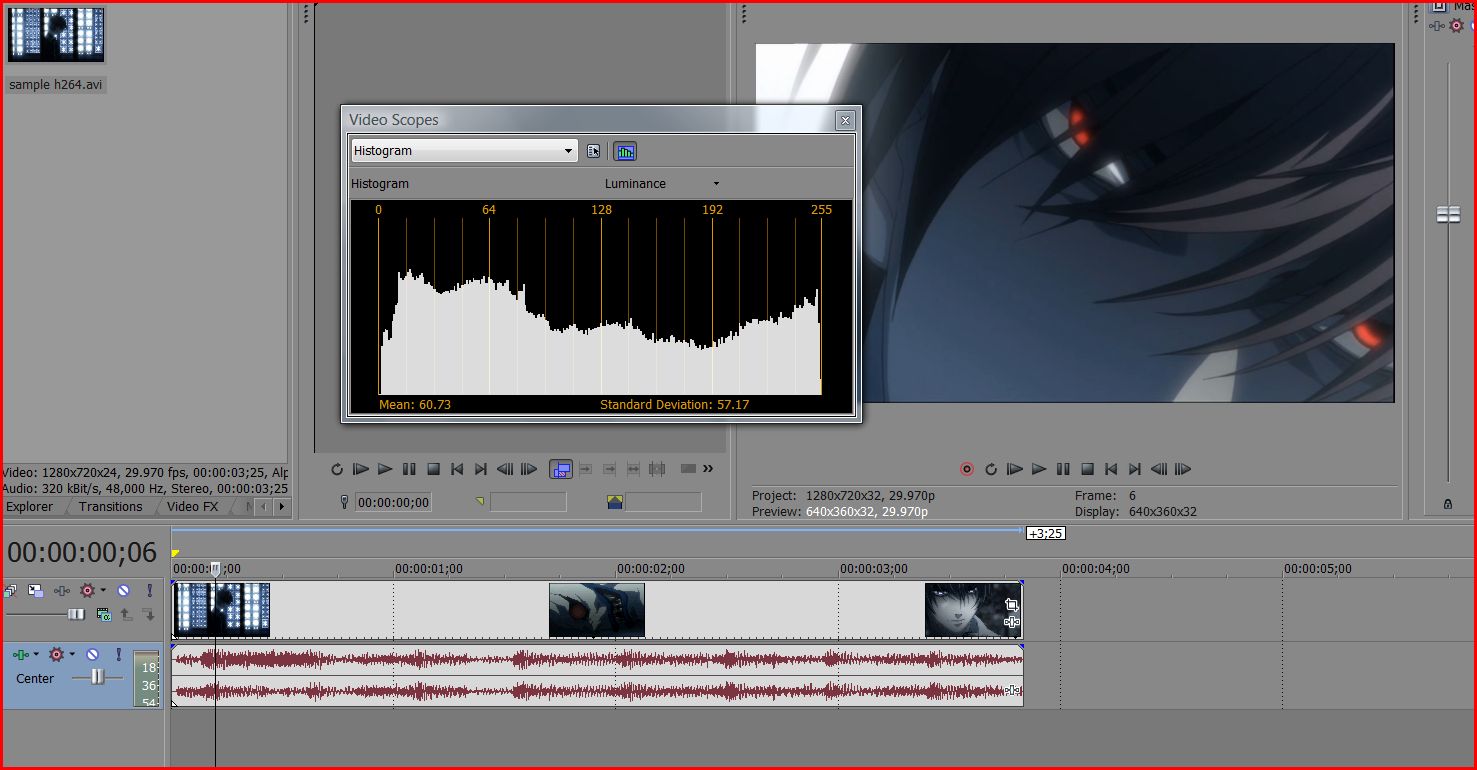

  15. Importing the sample h264.avi from ohnoeee into Vegas results in the levels being expanded to 0-255 on the timeline. Is there a way to avoid this?
    Also, the glennchan.info articles state the preview window in Vegas uses computer RGB not studio RGB.
