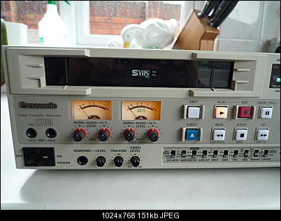

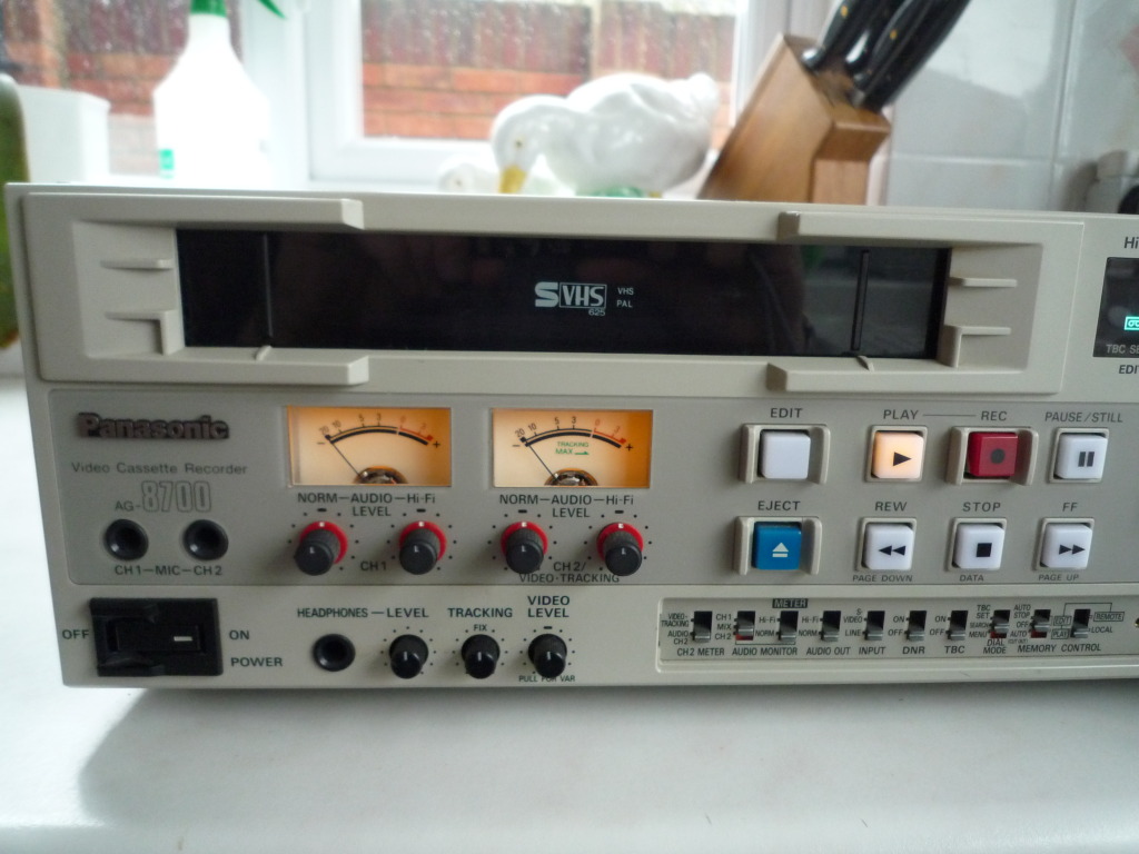

Does the Panasonic AG-7500 have a built in TBC? (UK/Euro model)
There's a switch labeled TBC that can be set to either 'normal' or 'external'.
On later Panasonic models which I know have TBCs the switch is labelled 'On' or 'Off'. 'Normal' seems weird setting name?
Anyone have a user manual to check for sure or able to shed light from memory? Thanks!

On these models the TBC was usually an option, not standard: it was a card similar to the PCI cards used in computers. The switch either activates the internal TBC card (if it has one), or patches the circuit thru to respond to external rack-mount TBCs or processors. Hardware at this level in that time period used a bewildering array of connection standards, many of which would bee unrecognizable as a normal video connection to the everyday user. The internal card would be the preferable solution today: remove the cabinet cover and look inside the unit for a TBC card. If it is missing, you might see an empty slot for the card. Other cards besides TBC were available, you may see more than one card or slot inside.
The 8700 does have built-in TBC and DNR, but note this still relies on accessory cards plugged into the main chassis. Over time, the socket contacts oxidize and trim pots on the cards deteriorate, causing video artifacts. While these production-quality Panasonics were extraordinary in their day for their intended professional use, they are not optimal to use in 2011 for dubbing consumer tapes to digital. Aside from possible TBC card degradation, the video head specs in these "pro" units are too wide for matched playback of typical consumer or Hollywood SP tapes: they add spurious noise and grit to the image you would not see otherwise. Assuming the TBC and DNR still work perfectly, they might conceal much of this, but its still a poor match. Unless you already own the 8500 and 8700, I'd recommend the NV-SF200 "semipro" model instead: it has more consumer-friendly video heads and better-integrated more durable TBC/DNR.
