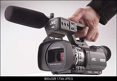

    Not many HD CCD consumer cams. The best one would be the 3x CCD $2750 JVC GY-HM100U. You can remove the fancy mic and handle to make it look cheap consumer.
    There are other 3ccd options for SD MiniDV.

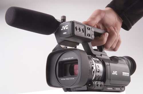

    thanks for the response edDV. too big and too $$. can't be discreet with those things at all.
    Needs to be this:
    Image Attached Images
