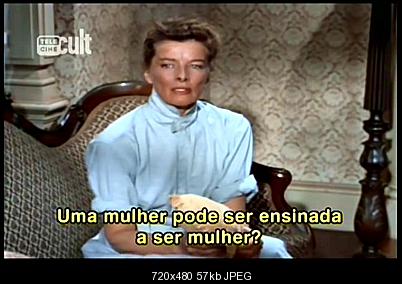

    The question now is how to increase quality on DVD subtitles.
    Working with DVD-Lab subtitles, on a NTSC video, I get below subs:
ID:	6327Name:  red2-dvd.jpg
    Also working with DVD-Lab, but with subs comming from MaestroSBT (bitmap subs), I get below subs:
ID:	6329Name:  red4-maestro.jpg

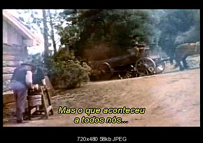

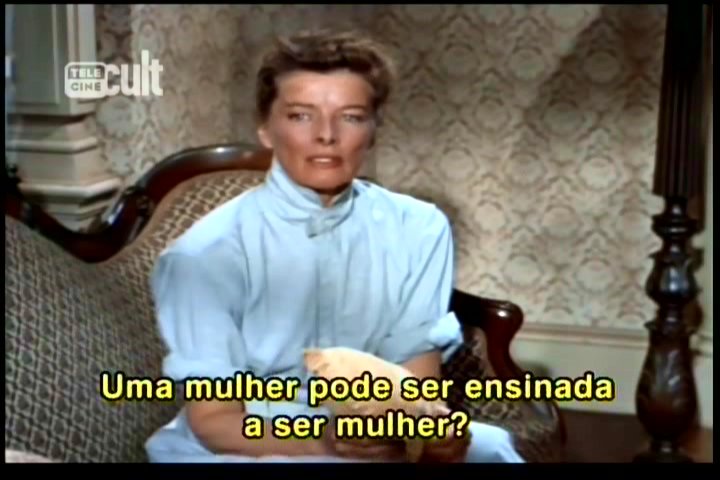

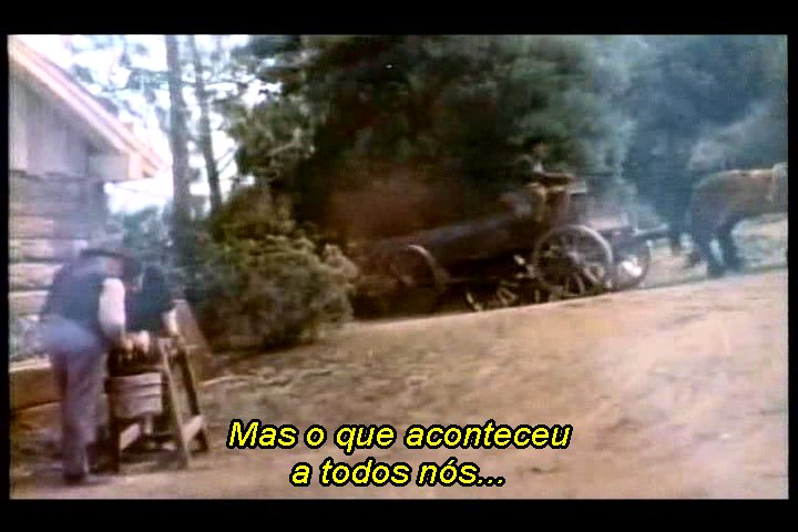

    As we can see, outline and letters looks bad. When I record a screen from TV, from a NTSC resolution (720x480), I see:
ID:	6331Name:  red1-TV.jpg
    I think to enlarge the resolution of the Maestro bitmaps to 1440x960, and bringing back to 720x480, changing dpi from 72 to 300. Unfortunately, the result is the same on outines and letters... The point here is not to enlarge font size. I want to keep them at Arial/Tahoma 22 or 24.
    Questions are:
    1 - How people at TV could do a better job using the same resolution? Or they use a bigger one?
    2 - Is there a better way to make subtitles more soft and clean using 720x480?
    3 - Is there another DVD author with handle subtitles with more quality/accuracy?
    4 - Someone could identify which font is used at TV screenshot?
    Thank you.

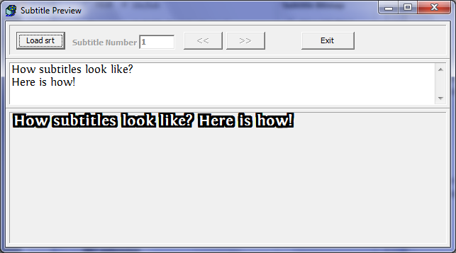

  2. I don't think you can totally get rid of the aliasing using selectable subs. Burned in generally look better. Also I've been playing around a bit with AviAddXSubs to create idx/sub external files for use with the WD set top box. I found the "Fontin" font looks much better than Ariel or Tahoma for subs.
    You can get free Fontin Windows TTF here:
    http://www.exljbris.com/fontin.html
    From what the author of AviAddXSbus says, the anti-alias is a function of the player. That's why burned in looks better since the video is encoded at the time and some anti-alias is applied then. The TV picture that looks good is probably hard subbed.
    http://milesaheadsoftware.org/
    Fully enabled freeware for Windows PCs.

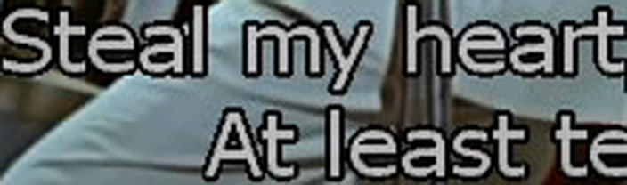

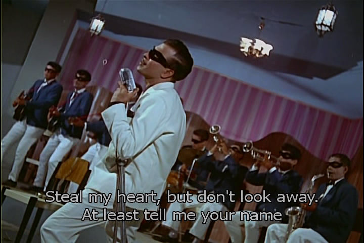

  3. Using an antialiasing color definitely helps. These are created using MaestroSBT, also Tahoma:

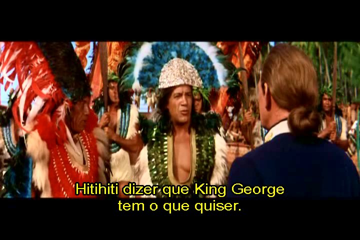

  4. Here's a sample using Fontin font. Font size 16 bold with border width 3.
    (Of course this is different than DVD subs. For my set top box I have to take into account the upconversion. If the source is SD then the subs are going to be larger than if the source is 1080 etc..)

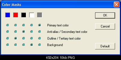

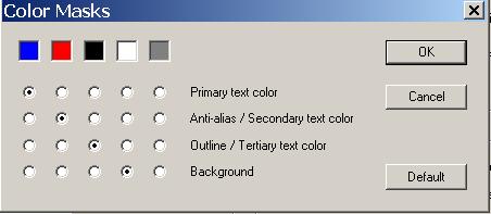

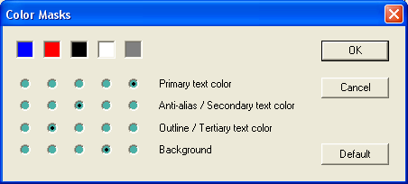

  7. The BMPs can only use 4 colors. They aren't the 'real' or final colors. Those are overlaid on top depending on what colors are defined in the IFOs. If you're ever displeased with the final or displayed colors chosen, they're easily changed using either DVDSubEdit or PGCEdit. I use PGCEdit. It doesn't even matter what the 4 colors are. I think I'm just using the defaults. What's important is to choose 3 colors and not 2. You'll see the colors MaestroSBT gives me, but I always make the 'real' colors light grey/dark grey/black:

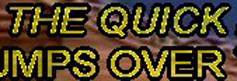

  8. Hi Manono
    I'm following the path. Put the color settings at MaestroSBT as you said, "Only one set of text, antialias and outline colors", and the same default settings you use.
    MaestroSBT gave me:
    Then I run DVD-Lab, and the sub was:
    Then I tryied to change colors. First, I use this guide:
    http://forum.digital-digest.com/attachment.php?attachmentid=4201
    Here is the original settings for VTS_PGCITI - VTS_PGC_1:
    But changing color 0, 1, 2 and 3 I got no change. So, found out that color 5, 6 and 7 were the targets. But I listen your advice and tryed also PGCEdit. Here the original CLUT:
    Because I want yellow text and black outline, I changed colors 5, 6 and 7 to this:
    And the result was:
    As we can see, yellow text is something transparent and there are some kind of white or yellow around the place where should be the antialias. Am I doing right? Is it possible to make yellow more bright?
    Is there a better way to know which colors are right ones than to try to guess, over and over again?
    You said you use light grey/dark grey/black. Before, you sent an example of that. But what to do when the goal is yellow and black?
    Thank you.

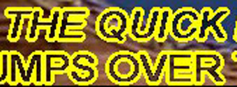

  9. You got the colors wrong. You wound up with the yellow as the antialias color and the dark yellow as the main color where it should be the other way around. Here's a guide to doing it using DVDSubEdit:
    http://download.videohelp.com/DVDSubEdit/Guides/ChangingColors/Guide.htm
    Once you've done it a couple of times it'll take about 30 seconds to do. I don't use DVDLab, so I can't help there. I use Muxman and it always puts them in the top row, and I can quickly change them using PGCEdit. Once you figure out where DVDLab puts them it should go just as fast for you.
  10. I've already read that guide before (DVDSubEdit) and I was keeping it to last resource. Because I'd like to understand better how CLUT actually works. Yes, I was changing fore color and antialias color, of course.

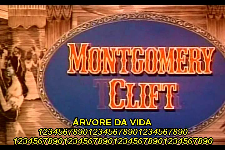

    <loud> Hello folks, does anybody know what is this font? </loud>
    Thank you.
