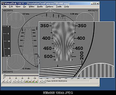

  24. Why do you need to see the video on a separate monitor? Are you just looking for the larger size? Do you need the video proc amp to adjust the picture? If you just need to see more detail maybe you could settle for a screen magnifier?

    Tried MirrorMon with no change in results. Still very blocky video. Again, tried many different settings. Like I said in the very beginning I think I'm beating a dead horse... I'm usually pretty good at trouble shooting, but I must say this one has really got me stumped. I'm beginning to think that there is no solution until Microsoft puts this feature back in like it was in XP. And we all know that isn't going to happen.
    Thanks all for your help...I'm still open for any solutions that any has tried that really works as I've described in previous posts.

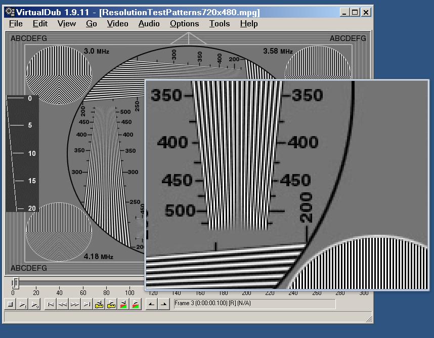

    I tried Actual Multiple Monitors last night. I was able to get the mirroring function working reasonably well. Based on what I saw, it won't replace ATI's Theater Mode or NVidia's Full Screen Video for HTPC users who want to feed video to a remote TV and also watch using their monitor. However, if Actual Multiple Monitors is unsatisfactory for client participation in the editing process, then I think you will need to go back to Windows XP to be happy.
    I set up 2 mirroring profiles for the output window, one using "Window" as "Source Type" and the other using "Part of the Desktop" as "Source Type". Using "Window" placed the entire MPEG Video Wizard DVD "Output" window, including its borders, inside another window, for a smaller picture. "Part of the Desktop" offered a larger view of the video, but the MPEG Video Wizard DVD "Output" window should not be moved or resized when using that setting, because only a fixed area of the desktop is mirrored.
    My second monitor is a 1280x1024 CRT monitor, set to display at 640x480 resolution. The picture is overly dark and can't be made brighter. (It is worn out and slated for recycling.) For that reason I evaluated the "Part of the Desktop" mirror window on both monitors. Outlines were jaggy and the picture was full of interlacing lines. However, that is only because of the the poor video rendering in MPEG Video Wizard DVD's own "Output" window. Motion was not as smooth as the original, but not terrible. The picture was only slightly more blocky than the original MPEG Video Wizard DVD "Output" window.
