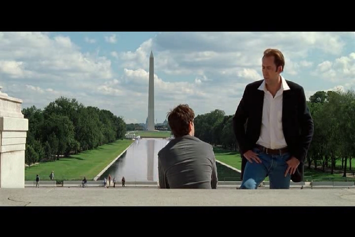

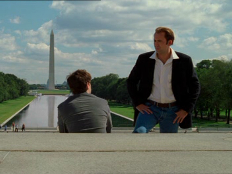

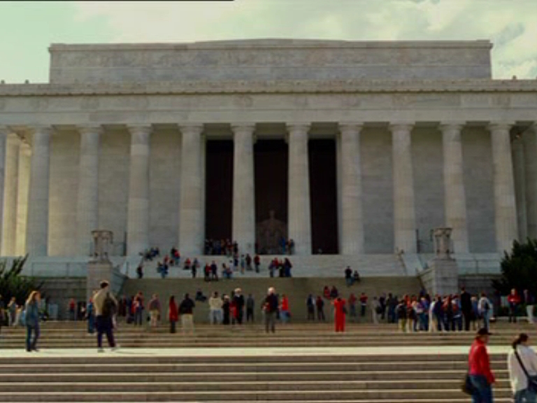

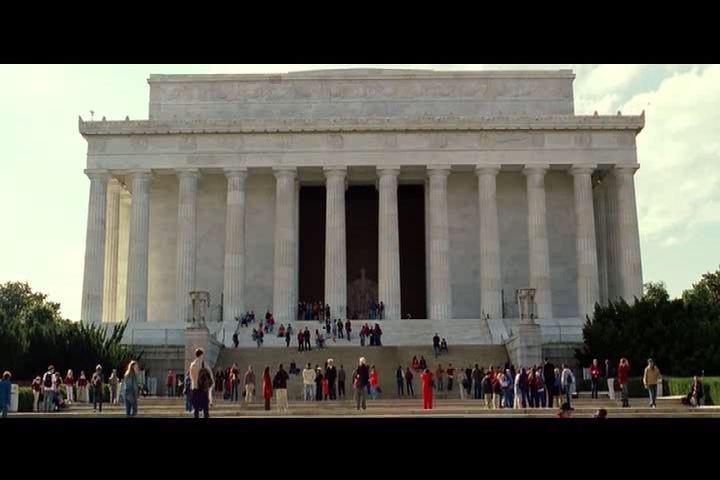

  28. USA uses NTSC (29fps) standard, however if you take PAL DVD to usa it will still play. The TV does not disable that. Check with g-spot or mediainfo application source DVD format. if NTSC keep NTSC, if PAL, then you keep it is as PAL only. simple diff notice the attached files
    you will notice Diff between 720x480 wide (converted from DVD) and 352 x 288 PAL video.
    on the whole people like NTSC, me too, even when i am in India where PAL is standard.
