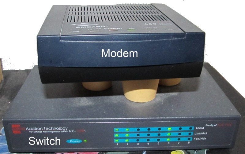

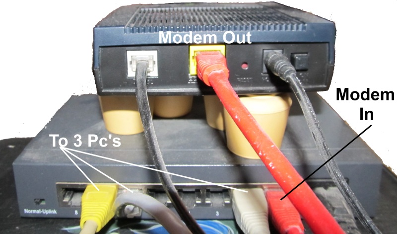

    basically my setup is as follows
    dsl line (6mb's) -----> modem ----> switch (runs to 3 pc's)...no issues
    i liked the idea of the wireless router because it already contains a "switch (not a router..just a cheapo $10 switch)" so if i needed to turn off the wireless i could and it would still be alright with the lan connections.
    how would hooking up an access point work?...would the line-in into the access point be from the modem itself or just another line from the switch?
    I won't be using any of this for anything advanced...just surfing etc. It would be used minimally at the most.
    what w-routers/access points are the least complicated to use? user-friendly i suppose
    I don't know how that could work.
    You normally use a router to share a net connection with 3 PCs.
    It allocates each device to an IP on your LAN and forwards them to the Internet, and vice-versa.
    I suspect your "switch" is actually a router.
    (Unless the modem has a router built in, as is possible.)
    What model is the switch?

    Nov 2005
    it's just a basic switch...been using it about 6 years. Never had to configure anything with it.
    This setup with 3 pc's has been going for the last 2 years. 2 pc's for the last 6 years w/o issues.
    I think your modem is also a router.
    This one: http://embarq.centurylink.com/embarq/refDocs/user_guides/internet/HSI_660dhcp_Guide.pdf
    If so, you should see its config page at http://192.168.2.1
    And your password will be "1234" (I.e. the same as your luggage, but doesn't matter much for a wired router)
    They could have had several ports on it for minimal cost and you wouldn't have needed the switch.
    Anyway, with that you can plug an access point into your switch and it should get an IP from the modem/router.
    But a wifi router probably costs about the same and would replace the switch too.
    You could either configure the modem to be just that, or the router to be just a switch ("bridge mode"), because otherwise you end up with two levels of readdressing.
