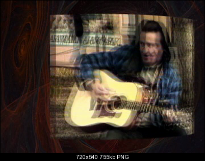

    weird. when i play it in vlc i see this.

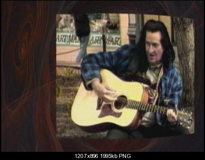

    but a screenshot by vlc gives this. which is what i assume you're seeing. it appears the motion video isn't being rendered properly.

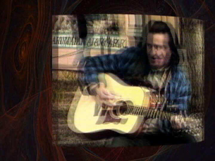

  7. There's absolutely nothing wrong with the MPG video. It is interlaced and bottom field first. If you aren't getting proper playback it's your player's fault. Simple Bob Doubler in VirtualDub:

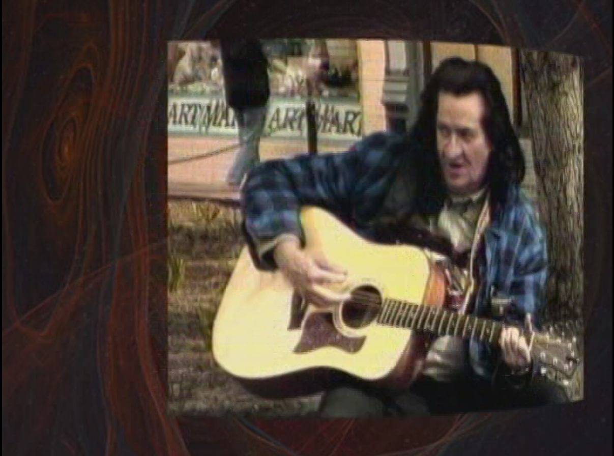

  8. set vlc to "bob" and you should see similar to what WMP shows when playing the original DV-AVI
    as jagabo pointed out , wmp will automatically double rate deinterlace DV-AVI (if you have default setup with MS codecs) . Most players will only single rate deinterlace, for example KMP will only single rate by default (so it displays as 30p instead of 60p)
