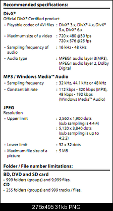

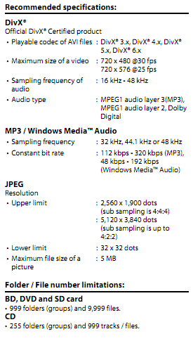

  9. From what information I can find about this player, it's DivX playback capabilities are as follows.
    So it seems that DivX HD is not an option.

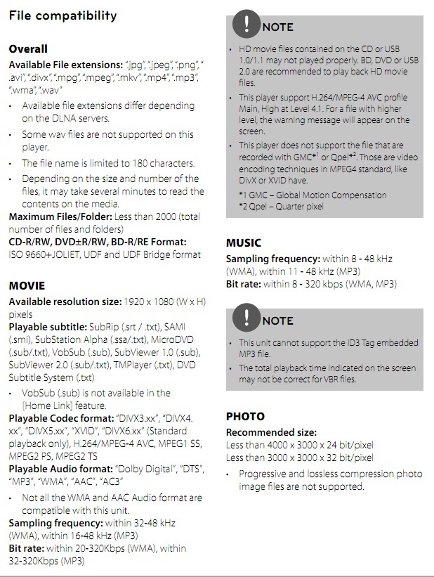

  13. The LG bluray specs say it doesn't play avi or divx files.....mkv, vc1, mpeg2 and avchd is all it will play but if you read the manual there might be some extra containers like mp4, I doubt even xvix in a mkv container weill work since it's not designed for that format.
    The BD670 will do what you need and more.

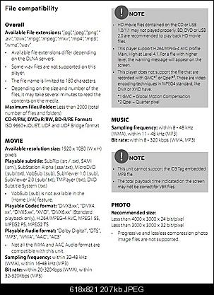

  19. I have been drooling over the LG BX580, which has USB, WiFi and DLNA as well as an impressive list of supported video file formats.
Name:	LG BX580.jpg
    I'll check out a few more reviews before I take the plunge though.
  20. Attached is a small Div3 AVI file from the Divx Test CD:
    http://divxtest.surdvd.com/sommaire.php3?lang=en
    You can also see how different players' Divx support compares there. I don't think it's been updated with Blu-ray players though.
