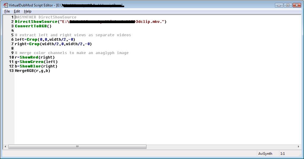

    Well I'm back at this. I did purchase the stereoscopic player and it works great. I want to make a combined anaglyph file from a side by side file I made from one of my 3d bluray discs I bought and ripped with dvd fab 3d bluray ripper to side by side mkv.
    Here is what I am trying to use:

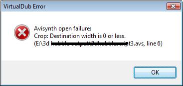

    I get this error:
    What do I need to do to correct this?
    The file is a uncompressed yuv clip from the original h264 file that bluray 3d ripper created - chopped with virtualdub for a 10 second or so test clip.
    It is 1280x720 at 23.976.
    Your help in correcting this script is appreciated. Thanks.

  9. Member Cornucopia's Avatar
    Well, it looks like you must have mistyped...
    Should be
    left=Crop(0,0,width/2,-0)
    right=Crop(width/2,0,width/2,-0)
    Jul 2009
    Spain
    The only way that line 6, left=Crop(2,0,width/2,-0), can produce the error "Crop: Destination width is 0 or less" is if Avisynth thinks the clip has a width of zero. (That would still apply if you had used Crop(0, ...)).
    This suggests DirectShowSource is not opening your file correctly. Test this by using this script on its own:
    DirectShowSource("E:\ ... 3dclip.mkv")
    Info()
    You might have more success replacing DirectShowSource by FFVideoSource (from the ffms2 plugin).
  11. In "left=Crop(2,0,width/2,-0)" the leading 2 may cause a slight misalignment of the two frames.
    Do you really need to adjust the parallax? That was given earlier just as an example of how to do it (and, arbitrarily, by 16 pixels). Not an indication that it was necessary.

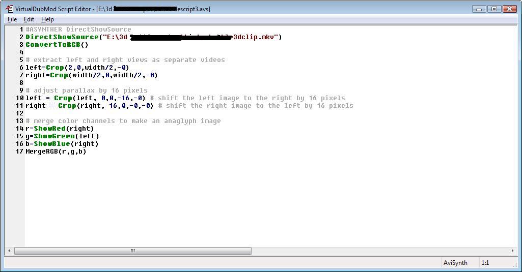

  12. Member yoda313's Avatar
    Jun 2004
    The Animus
    @gavino - I think it might have been because my clip was yuv uncompressed. I used x264 and made a h264 mkv file to work with. I can open that on its own just fine with directshowsource.
    When I replace that in the script I still get the same message.
    @cornucopia - I have changed the 2 to a 0 and still get the crop error message.
    @jagabo - I have removed the adjust parallax lines. I still get the width is 0 line 6 error message (but I can open the new compressed file on its own with directshowsource)
    You're help is appreciated. Thanks.

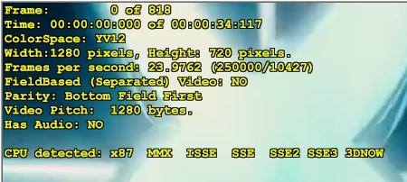

  13. What does Info() say about your source (using Gavino's script)? Especially the frame size.
  14. Member yoda313's Avatar
    Jun 2004
    The Animus
    I used mediainfo and the compressed file I'm using is still 1280x720.
    How do I use info? I tried a simple script with one line of Info(filename.mkv). It said it was expecting a , or (. What else do I need? Do I still need to do directshowsource first then the info line?
  15. No, you want:
    DirectShowSource("filename.mkv")
    Info()
    You should understand this basic stuff by now. Have you ever bothered to look at the AviSynth manual?
  16. Member yoda313's Avatar
    Jun 2004
    The Animus
    Ok I missed the "" in the directshowsource line. I used what gavino posted as you suggested. Here is the snippet from avisynth info:
  17. Ok, that confirms AviSynth got a 1280x720 frame. The script in post 42:
    https://forum.videohelp.com/threads/333552-What-program-to-convert-sbs-left-right-to-an...=1#post2074190
    Is your current script that's causing problems? Which line number? The same error message as before?

    #ASYNTHER DirectShowSource
    DirectShowSource("E:\high def captures\*****test 2.M2TS")
    ConvertToRGB()
    # extract left and right views as separate videos
    # adjust parallax by 16 pixels
    left = Crop(left, 0,0,-16,-0) # shift the left image to the right by 16 pixels
    right = Crop(right, 16,0,-0,-0) # shift the right image to the left by 16 pixels
    # merge color channels to make an anaglyph image
    r=ShowRed(right)
    g=ShowGreen(left)
    b=ShowBlue(right)
    MergeRGB(r,g,b)
    You start with a 1280x720 file, as mentioned in your 1st post.
    You split it in 1/2 horizontally, so you end up with 2 files each 640x720.
    You've got a crop to implement a parallax adjustment (aka Horizontal Image Translation, or HIT).
    While this may be appropriate for what you wanted to do, it's not complete as an HIT function, because it changes the AR and because it doesn't include padding which is meant to represent the "floating window". This is important in maintaining the positive reinforcement of and lack of disconnect between convergence, occlusion, and size, furthering the "realism" of the 3d image.
    So now you've got 2 files of 622x720.
    So you add a line in the script to pad them the complement of what was cropped (16). So now you've got 2 files of 640x720.
    Merging makes it 1 file of 640x720.
    You now need a 2:1 AR readjustment to get back to what SHOULD have been an original (2D) image (or would have 2x this for a 3D image).
    So you add a final line in the script to resize to 1280x720. Or you could do the resize before the crop&pad - to keep the crop&pad edge from getting fuzzy - but the resize, crop, &pad would take on different dimensions.

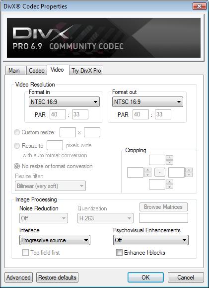

    Here is the frame detail of the converted divx file:
    1280 x 720 (AR 517:240) - from mpchc.
    Video: DivX 5 1280x720 23.98fps 2867kbps [Video 0]
    Audio: Dolby AC3 48000Hz 6ch 448kbps [Audio 1]
    It looks good it just needs to be encoded to 16:9 1.85 so the proportion is correct.
    FYI inside the divx config screen I have the video in out resolution set to ntsc 16:9. Is this throwing off the resize function and double squeezing it instead of leaving it at 1.85?

    Do I still need the bilinearresize AND the lanczosresize line together? Are they counteracting each other or are they complimentary?
    Edit - in the divx video tab should I set it to SQUARE PIXELS? Would that make the video 1.85:1 instead of 2.35:1?
    Thanks again.
Name:	divx setting.jpg
  24. You only need one resize.
    If you resize the frame back to 1280x720 the pixel format is square (PAR 1:1), not 16:9.
  25. Member yoda313's Avatar
    Jun 2004
    The Animus
    Ok let me see if I have this right:
    Delete the bilenear resize line
    Set divx video size setting to square pixels
    leave lanczos in at 1280x720
    Those configurations should give me the proper aspect ratio for the video?
    Thanks.
