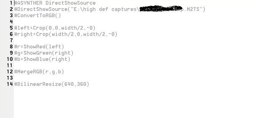

    I don't know what's going wrong with your script. Comment out everything (put a # sign at the start of every line except DirectShowSource()) and make sure you can open the source video.
    DirectShowSource("SBS.mkv")
    #ConvertToRGB()
    #left=Crop(0,0,width/2,-0)
    #right=Crop(width/2,0,width/2,-0)
    #r=ShowRed(left)
    #g=ShowGreen(right)
    #b=ShowBlue(right)
    #MergeRGB(r,g,b)
    #BilinearResize(960,540)

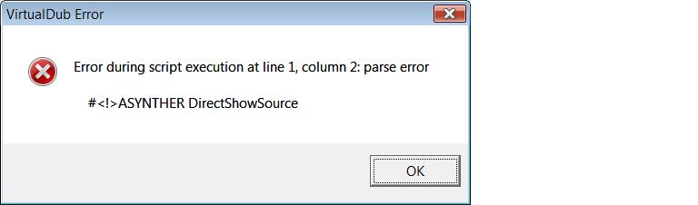

    I tried opening an edited version of what I just posted in virtualdubmpeg2 and I received this more detailed parse error message:
    Perhaps this gives more information on what I'm doing wrong?

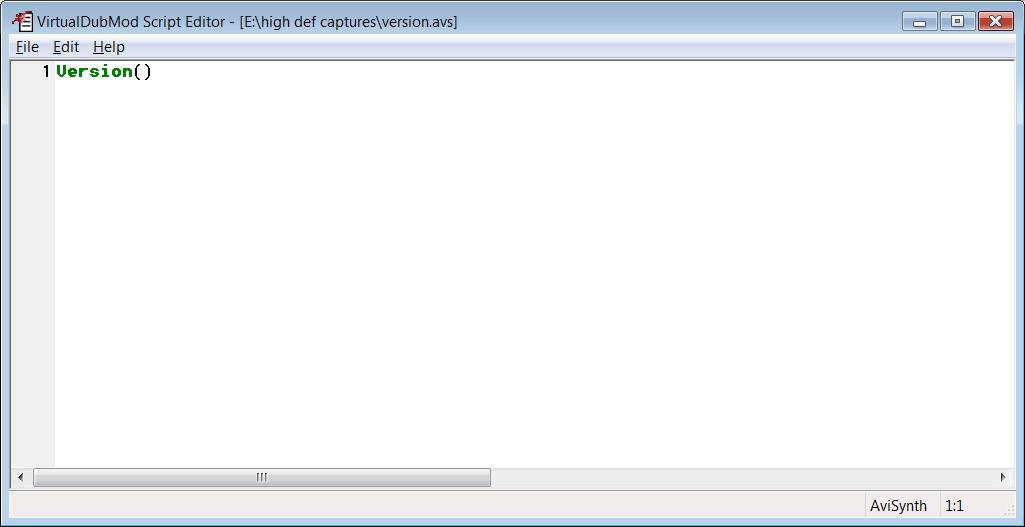

    Ok I'm now using notepad and saving as a .avs file. Before I was using the script editor in virtualdubmod. Was that incorrect?
    Originally Posted by jagabo
    Make a script that just has the command Version(). Open that in VirtualDub/Mod. You should get a gray window with the AviSynth version number printed in it.
    I did that once with the # and got a parse error. I did it without the # sign and got "variable not found" error message.

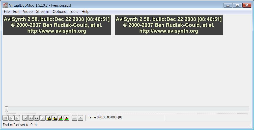

    SUCCESS ON THE VERSION SCRIPT!:
    Stupid newbie issue there. I had tried doing the RUN SCRIPT instead of opening the .avs file. Once I opened the .avs file that popped up. I had reinstalled avisynth but it looks like it was what I had before.
    Well I think I'm closer now....

    The clues to yoda313's script problem were actually clear from the start:
    Originally Posted by yoda313 View Post
    I then clicked run script and got a "PARSE ERORR" message. (the window box that pops up says sylia script error in the header of the parse error message window)
    As well as the mistaken use of 'run script', note that sylia is VirtualDub's script processor - and Avisynth error messages don't look like that.

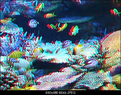

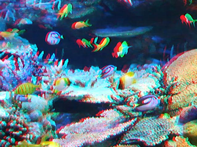

    I got a working output file from it now that I got the procedure correct. However it looks just like the input video. The output is still side by side with nothing overlapping to give a 3dish image.
    I will keep fooling with this now that I know the proper way to work this stuff.

    Did you re-enable all the script commands (ie, remove all the # signs)? What you see in the input window should be the anaglyph video. A # sign in an AviSynth script disables everything to the right of the # sign. If you put a # sign at the start of the line you are eliminating that line entirely.
    I had not.
    I have taken them out and reprocessed the file.
    I do now have a combined file of the sbs. Thanks.
    It is interesting to note however that at least on first inspection with the naked eye it appears to be a standard frame now. Unlike the stereoscopic player the image seems to be perfectly blended. Without glasses it looks nearly pristine, no ghosting artifacts that you would associate with 3d when viewing 3d without glasses that is.
    Is there a parallax adjustment to be made inside this script?
    Or is this something that won't be an issue when I do pick up the standard basic red/blue glasses?
    Thanks for helping to iron this process out. I guess I"m there but I won't know until I pick up the glasses.
  22. There should be obvious areas where the left and right images don't line up:
    You can adjust the parallax by shifting the images left or right with Crop().
    Ok I do not get that result.
    What range does it go to? I see in the crop line it only shows 2 and 0. How high does it go? What is the minimum and maximum value you can use? I don't think I want to go too extreme but there doesn't seem to be any deviation from a nicely blended image when using the values you had posted.
    Thanks.
