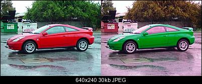

  11. Inverting the V channel would cause red to become green and greens to become red. But that would happen on all players:
    normal V / inverted V
    But I'm not familiar with rec.624. What if it uses an inverted V channel (compared to rec.601) and some players are ignoring the chromacity flags? Then players that pay attention to the chromacity flag will display the colors correctly, and players that ignore the flag will reverse the reds/greens.
