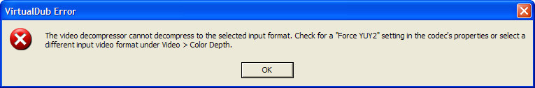

  1. I can scrub (it's not "frozen") but the screen is grey (output and input pane)
    manually choosing output format to the same settings (instead of "same as decompression format") makes no difference
    pressing "play" results in error with those color depth settings as screenshot:
    (those output format settings don't make sense anyways, because it has to be converted to RGB for display, you cannot view Y'CbCr directly on a monitor, they work in RGB. Ie. it has to be converted to RGB for display somewhere along the line)

  2. Try with:
    Decompression format => Other... => YCbCr (Rec.601) Limited 4:2:0 interlaced
    Output format => 24 bit RGB
    Then open the video and when it show a gray video press play.
    Codec Toolbox RS (A tool to read/change merit of codecs and many other things)
  3. Yes, I already have, same error when pressing play. I've tried multiple combinations.
    In your "bug report" , some of the options do "work on the fly" correctly (i.e without having to close & reopen) , for example, using luminance works fine (black & white) then switching back to autoselect works fine too

  5. The error does make sense, because interlaced YV12 4:2:0 doesn't exist in the vdub world or the official fourcc specs
    Interlaced Y'CbCr should always be YUY2 or 4:2:2
    But I'll try your suggestions leaving only a freshly downloaded MPEG2 plugin in the plugins folder , and report back only if they make a difference

  8. I have re-tried now and the "play button with the O" give the same error as you get but the "play button with the I" (that I was using) works fine.
  9. ^Yes it works! Thanks. I had been using the "o". You have to fiddle a bit with it but it eventually works
