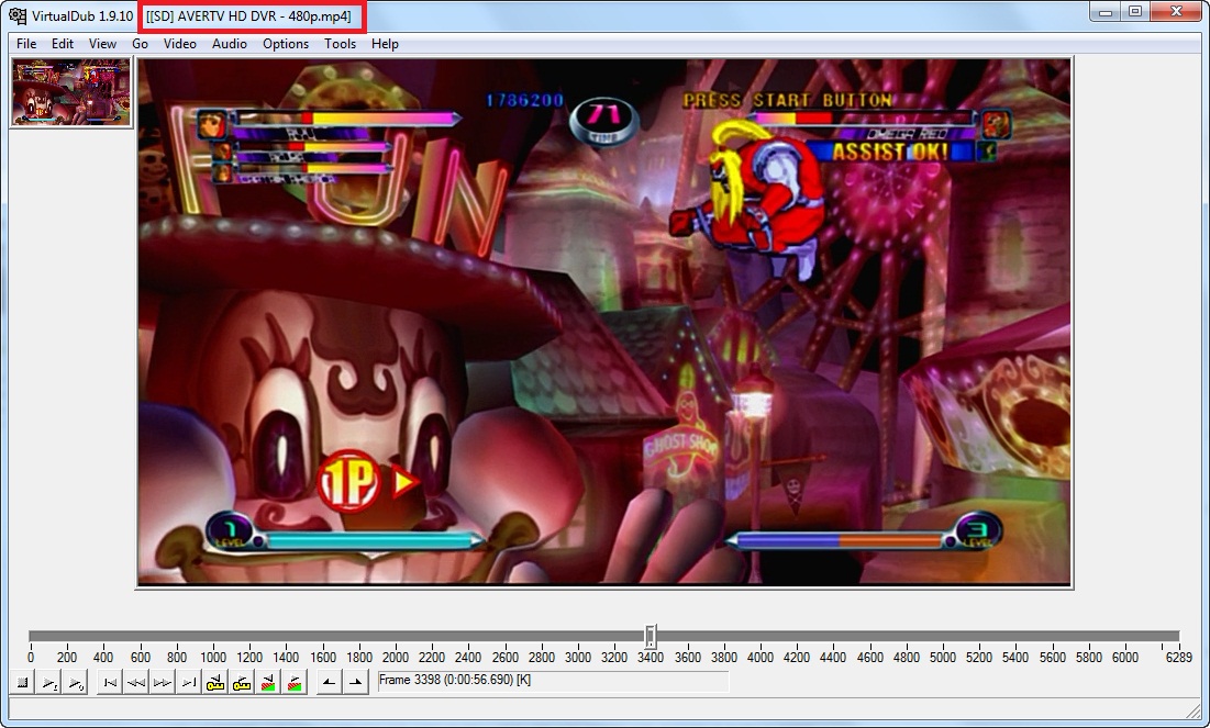

  10. Member s_joy09's Avatar
    Mar 2010
    Dhaka, Bangladesh
    Hi!
    First of all I'd like to thank everyone for the info.
    Cauptain, I have downloaded the Direct show Input driver, but I couldn't find any file named Plugins32 in my VD's directory there's a Plugin folder where all my plugins are kept.
    After I had extracted the DirectShowInput Driver I found three items there :-
    1. Folder Named "Release"
    2. Folder named "X64"
    3. Document named "Copying".
    Now I assume that its the folder named "release" is what I need but where shall I put it.
    Thanks again & T.C.
    Bye!

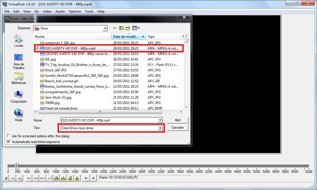

  11. Lone soldier Cauptain's Avatar
    Jan 2006
    Brazil
    Originally Posted by s_joy09 View Post
    Hi!
    Thanks again & T.C.
    Bye!
    No problem Sir.
    First of all download this plugin pack: Virtualdub Pack Extra Plugins
    In VD diretory make a folder "plugins32" and extract the Pack above and your OS version plugin Directshouinput (32 or 64 bits).
    Open VirtualDub and you'l be able to load all most common types of files (.wmv, .mpg or mpeg2, .flv, .mp4).
    Try and reply.
    Claudio

  12. Member s_joy09's Avatar
    Mar 2010
    Dhaka, Bangladesh
    Well sir, I have done as you had recomended, and now the file seems to load as it had after I had installed the " komisar's x264vfw.1924kMod ". With the same result, nothing is seen or heard on the VD's display but black screen.
    What do you think I'll have to do to get picture and sound on the VD.
    Thanks & T.C.
    Bye!

  16. Lone soldier Cauptain's Avatar
    Jan 2006
    Brazil
    First of all I'd like to make it clear to all of you masters that I've never used Avidemux [ just because the saved file is not a video file and can only be played with Avidemux].
    I need a lesson on using this program that so many say's to be very usefull, but for now after google' ing I was able to cut a clip from the video and that is what I'm up loading.
    Here I should inform you all that while trying to load the video to cut a clip, Avidemix informed me that the video has used B frame ?! and it could use a certain method. At this point I ignored the suggestion first and Avidemux crashed. Later after accepting the suggestion I was able to cut the clip. Thou I don't know why there is no audio in the clip.!?
    So here goes..
    Thanks!
    At first I wasn't able to upload the attachment as I didn't know the file format of Avidemux. Then I tried using .avs extension while saving the clip and that was my first uploaded attachment. The idea of using the .mp4 extension while saving the clip came after that.
    Strange...In Videolan I got normal video but no sound. In WMP I got slagged sound but no video. In VD I got nothing, plugin or AVS (audio + video). In MPC same to VD.
    I will install CoreAVC to test, Back in minutes.
    Claudio

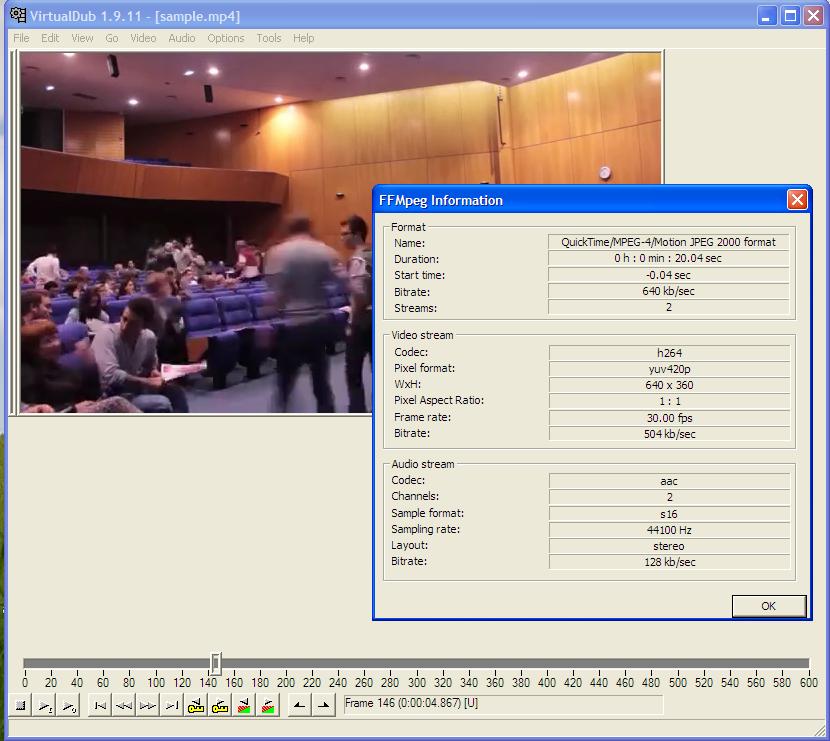

    Mar 2011
    Paris, France
    Hello
    I tried several of the plug-ins mentionned above to open an MP4 file (AVC1 + MP4A), but VirtualDub still says "MISSING CODEC (AVC1)".
    Here's the first 20 seconds of the file.
    VLC and ffplay.exe have no problem playing the whole file.
    I'm no video expert and would appreciate any idea about what other plug-in to try and edit the video (mainly keeping only some parts of it). I prefer VirtualDub to AviDemux.
    Thank you.
  21. DECEASED
    Jun 2009
    Heaven
    ^ yetanotherlogin, your sample.mp4 opens and plays fine under VirtualDub 1.9.11.
    Using fccHandler's Quicktime plugin ++ komisar's VfW codec r2245.
  22. Member
    Mar 2008
    Also works with the ffmpeg input plugin.

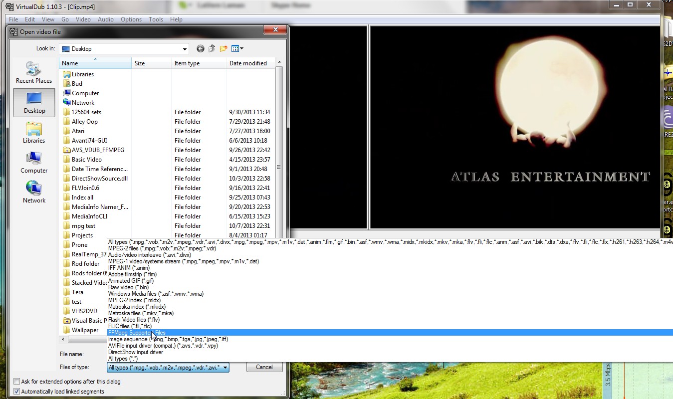

  23. Member Budman1's Avatar
    Jul 2012
    NORTHWEST ILLINOIS, USA
    Yes, I concur, it works also with the ffmpeg plugin. Don't forget to select it in file open dialog as type. Also I am using the FFDshow VFW
    plugin for H264 AVC;
Name:	ScreenHunter_34 Oct. 07 23.47.jpg

  25. Member Budman1's Avatar
    Jul 2012
    My system uses ffdshow where I turn on avc1 codec in VFW (ThATS VFW codecs NOT video codecs) and in Virtualdub use the ffmpeg plugin (in virtualdub/plugins32 folder) .
    Select file open and select type drop down ffmpeg. It loads fine.
