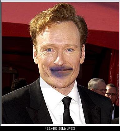

  16. I was able to put together an AviSynth script that takes live video from a webcam and overlays it onto a picture of a face with an alpha mask over the mask.
    vid=DirectShowSource("cap.grf", audio=false, fps=30, seek=false, framecount=100000).ConvertToYV12()
    pic=ImageSource("conan.png", fps=30, start=0, end=100000).ConvertToYV12()
    mask=ImageSource("mask.png", fps=30, start=0, end=100000).ConvertToYV12()
    Overlay(pic, vid, 150, 208, mask)
    cap.grf is a capture graph to get video from the camcorder, made with GraphStudio.
    The lighting was bad (my office) and I'm much scruffier than Conan, but here's a screen cap from the live video:
    Obviously, for this to work the speaker has to stay in exactly the right spot.
