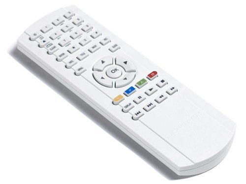

  12. I have a tried a number of Xbox 360 media remotes and they do vary in quality. There are some you might want to avoid.
    The first two are cheap and can be found all over the internet, but they dont have very good range and you have to have the aiming skills of sniper. The build quality isn't great, I actually broke one by dropping it 3ft onto a thick carpet.
    I'm currently using the Joytech model (bottom pic), it has good range and feels nice and solid.

  13. Member yoda313's Avatar
    Jun 2004
    The Animus
    Thanks for posting the pics mh2360.
    I am using the second one on the right of the top picture - the one with the number pad. It does have a narrow angle of attack.
